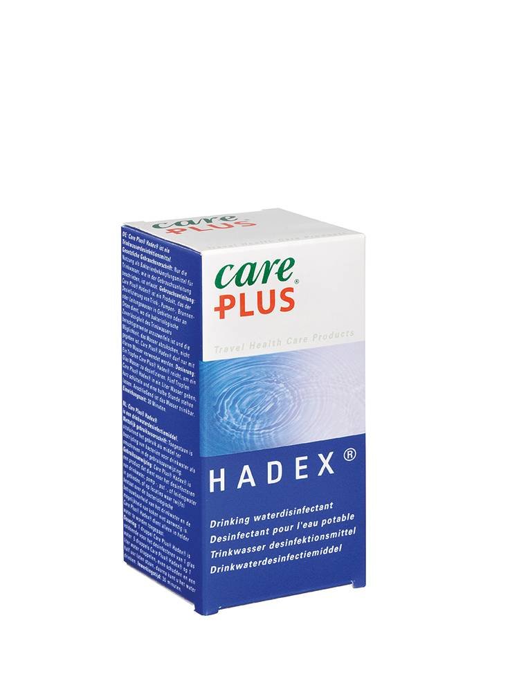

But when I fill the tank I would like to add some purification tablets to keep the water clean and drinkable for a while. That is easy in a jerrycan or tank with a big access hole. I used to work with small tablets that needed to be added per litre. So a tank of 52 litres needs 52 tablets. Problem is: they wont fit the small fill pipe. I looked for other solutions and found a liquid purifier (if that is the right word) and that has a droplet per glas of water... do the math that makes 4 droplets a litre x 52 = 208 droplets. That's a long annoying option.
Besides the droplets and maybe crushing the small purrification pills, are there any other possibilities that I can use in this particular case?

After a quick stop at the Pharmacist I found these.
How many do you need per litre of water? Does it do the same job of cleaning the water tank or just treat the water in it at the time? If there is a difference. I’ve also heard of people using Steradent tablets but not tried it myself.

It just cleans the water.
It needs 1 drop per glass, so for my tank it would be 208 drops to have clean water in the tank (Glas is 250ml so 4 droplets a litre x 52 = 208 droplets). (I use a syringe (without the needle) to insert it into the hose before I fill up the tank.)
I use regular teeth cleaning tablets to clean the tank. (twice a year)
