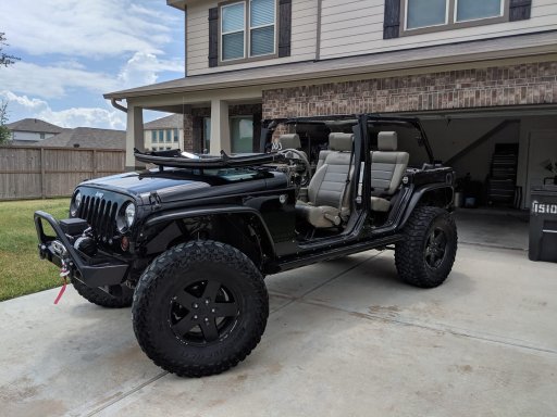

Ok I have an update! Fresh modifications!
I have 5:38 gears installed, still breaking them in as we speak.
Got Adams 1310 driveshafts front and rear installed.
Artec Truss kit installed.
Teraflex balljoints slapped in there while it was apart.
Have a Traildash2 to keep up with everything.
Aaaaand a Teraflex hinge carrier for my spare.IMG_1080.JPG9X5iDElRRpWz4l02qc2cBA.jpg9CkawAb2Q460TjiUBk1CPQ.jpg5368E8C3-6247-4264-8A65-928E2D2832A9.jpg

Today was a good day! Got a lot done to either fix or upgrade my project. Installed a new radiator, mine was leaking. Installed new thermostat and thermostat housing, it was also leaking. New radiator hoses, my lower had been rubbing the belt tensioner for some reason... installed an aftermarket power steering and transmission cooler. Just Empty Every Pocket indeed.

Finally it is where I no longer have to worry about a failure on the road! Got tires and rims to replace my very worn out tires I had and get rid of wheel spacers with the correct backspacing. Now running 37x12.50x17 Patagonia M/T. So far I really like them, much more quite on the road then my other mud terrains and they have better road manners. We’ll have to see what it’s like off-road here soon.

Really nice looking rig!

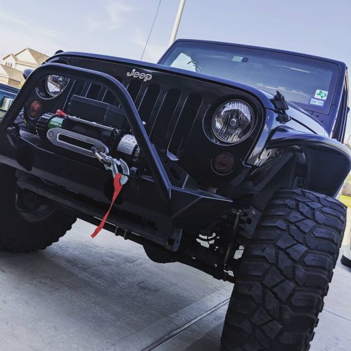

Not too much has happened since I got new tires and rims, went on a few trips. Colorado, and a few parks in Texas since then. Here are some little things I've added and a couple pictures from Colorado.
Added some MOLLE to my sport cage, I need to adjust it when I have the top off and relocate things. #raffleitemwinnings
Added some Rock Lights #amazonspecials
Here is one from Colorado for good measure.

I’ve been following your rig build, it is really coming together! Looks great! You and I are going along the same path!
