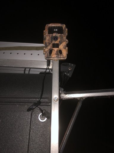

Finalized the water heater bracket, made the decision to extend the diesel heater exhaust above the cap instead of by the truck exhaust, testing a usb trail cam to see those midnight visitors!! All the while my pal, Luna was enjoying the sleeping pad!

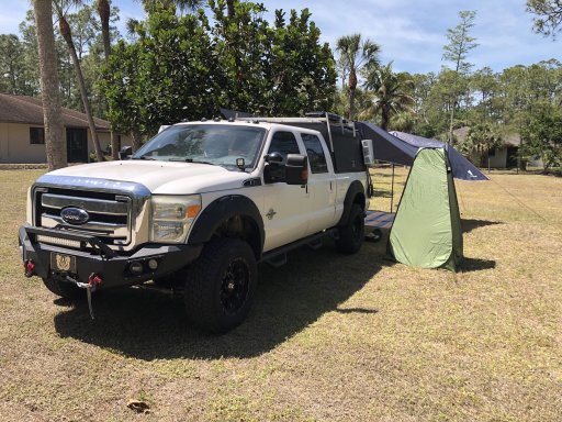

Making the call! Build is complete.
Sure it will change over time, adjustments will be made, but it’s high time to hit the trails!
What a long 10 months it has been! What a lesson learned about the “cost” of this hobby! I am reminded about a long held truism that I have had since my first diesel in 2008. I dont drive a diesel for the gas mileage or complain about the cost, I drive it because I like it and it’s who I am! So I will continue to think this way about this hobby, I like it and I won’t complain about the cost because it’s Who I Am!
Now on with the adventures! I look forward to meeting you all on the trail!
I leave you with this pearl of wisdom that I have adopted and it’s crazy to think it came from a movie. Get busy living, or get busy dying !!!!!!!

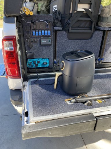

Ok, let the jeers and sneers flow! But I just had to do it! I got this super duper air fryer at Sams...I wanted to see how my batteries held up under a large amp draw. And they handled themselves marvelously!! At 400 degrees hot, it took 18 minutes to crisp some french fries! The batteries started at 94%, the fryer drew 344, 355 and 358 watts from each battery. That's basically 29 amps per battery. Specs say 1000watts (83amps) so it drew a little more than advertised (if the onboard battery meters are accurate)
At the end it only used 8% of the batteries. The best part is that in a short 15 minute drive, they were back to 100%! Love the Renogy 50amp dual charger!!

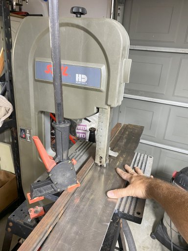

I started the process of making a magnetic bug screen for the 3 openings of the cap. Due to the aluminum cap, I cut 1" metal strips and screwed them on 3 sides. The bottom strip I used fuel line as stand off spacers due to mounting bolts of the cap being in the way. The top edge will be permanent and velcro straps will be used to hold the rolled netting up!
Tomorrow, I will install the metal strips for the other sides and start the sewing process! I will be using 2"x1/4" rectangular magnets sewn in a reinforced edge banding. I have left over cloth from the bed cushion which is a perfect fit! If all goes well, I will post the finished product soon!.
