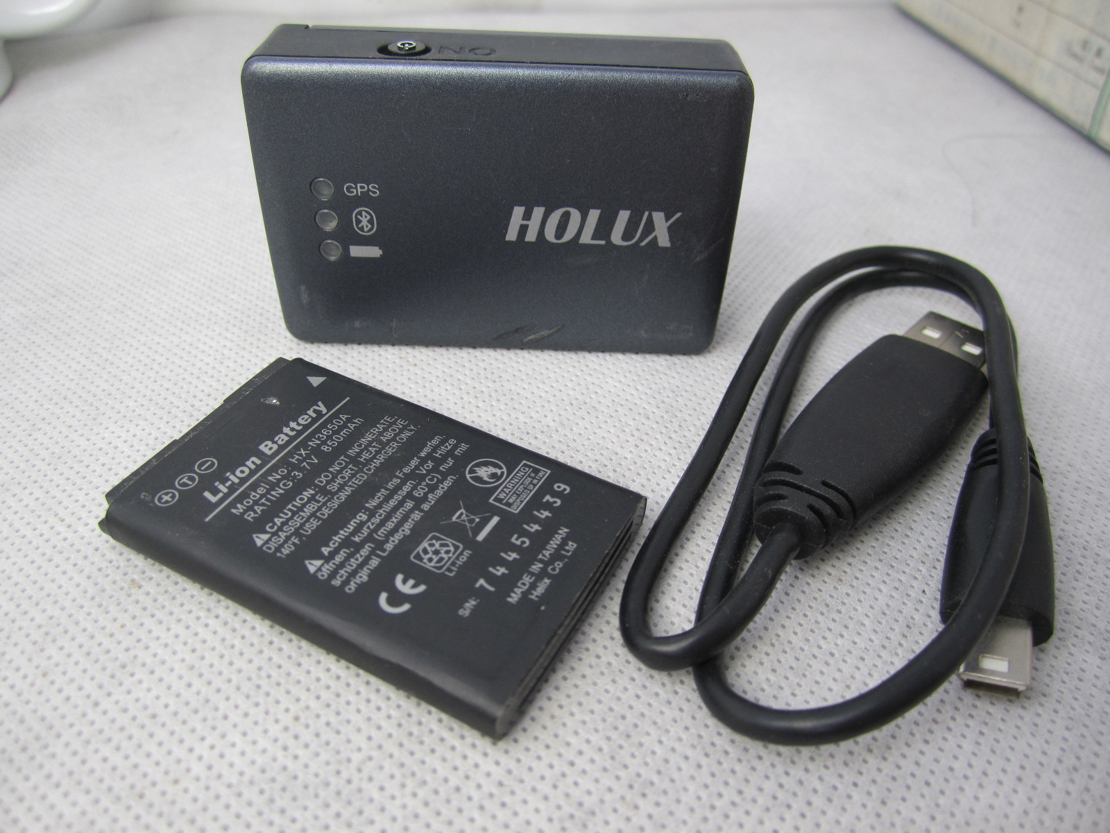

Here is the Hollux GPS receiver I use (about $50)

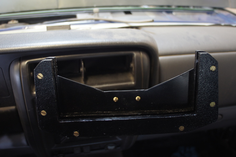

Here it is mounted on my dash (also shown is the tablet mount I made out of two pieces of cutting-board)

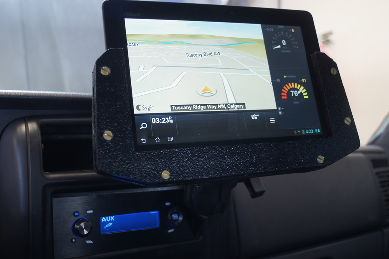

Here is my home-made setup showing Ulysse Speedometer Pro

And here I'm using "Sygic GPS Navigation & Maps" for navigating around town

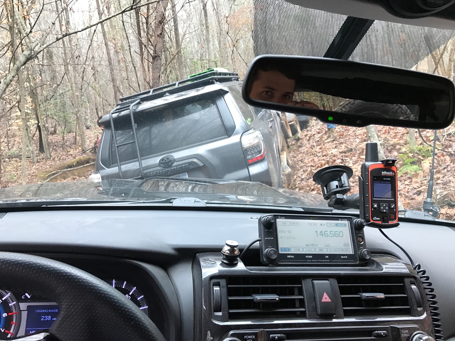

The Delorme (now Garmin) inReach Explorer with an iPhone 6 Plus, rocks! Just download all maps to your phone or tablet and you are good just about anywhere with the Earthmate, or GAIA apps. Of course the added piece of mind that you have a two way communication SOS beacon device that works via the Iridium satellite system is just the icing on the cake! Just got it setup so I haven't tried the tracking feature yet. What's really cool is it allows you to post your GPS location to a webpage or social media where your friends can follow along with you while out on the trail.

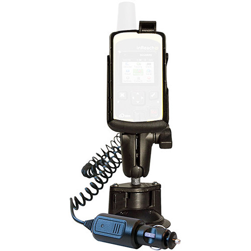

Also going to be replacing the Arkon phone holder seen in the above pic with one of these that is designed to specifically fit the inReach SE/Explorer models available at B&H for $59 (no tax, free expedited shipping).
****UPDATE and product name correction 03/14/17***
I finally got around to purchasing and installing the new Delorme/RAM (not Arkon) mount from B&H. And like most RAM mount products I've purchased in the past, this mount is extremely well built, and will hold your device firmly in any position for years of use. You have the choice to use the cup holder attachment/mount, or you can just screw your RAM ball base mount to fit your desired surface or application. I happen to already own a ProClip mount, so I just screwed the RAM base ball mount direct onto it and I must say I'm very happy with the results. A bonus is that you can just leave the device plugged in and setup your InReach to power on and off in sync with an external power source (aka your 12v accessory receptacle).
