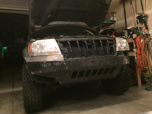

Test fit the bumper on the jeep and I wasn't a fan of the gaps so I broke a bunch of the welds and I'm rebuilding the bumper on the front of the jeep so I can dial in the gaps a little better.

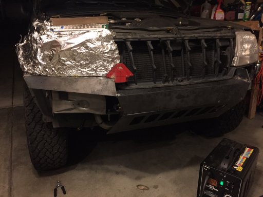

Had some time to work on my bumper project. I drilled 3 mounting holes for the mounting brackets on the passenger side, I broke 2 drill bits doing it, but once the mounting brackets were done I was able to build the passenger side of the bumper. I wanted to tack it together on the Jeep so I could custom fit it to minimize the gaps and what not. I covered the headlight and fender in a few layers of aluminum foil so I could tack weld near them and not get slag on anything. It worked well, I wouldn't try it for anything more than tack welding though. After I got it tacked together I took it off the Jeep and welded all the joints solid. I starting using Hobart brand welding wire last night and I'm really impressed with it. It seems to carry more current and get better penetration than the Lincoln or Forney brands of wire I've used before. I was able to weld faster with it too. Hopefully next weekend I can do the other side. I still have to install recovery points, and figure out how I'm doing fog lights before I can paint it and install it for good. I'm debating adding a front receiver hitch while I'm at it. While installing the receiver its self would be easy, I would need to build more a support frame for it behind the bumper because 3/16" plate isn't enough for a tow hitch. I'm also debating if I want to do brush guards for the grill and head lights.
Did you make your entire bumper out of 3/16ths? If so should have made the mounting hardware out 1/4". If you did that disregard this whole post lol
If your looking for a tow behind setup with a tow bar just mount your d shackle mounts to the exact length the tow bar is and bam it's tow capable. that's what my welder did, I think he put em like 32 or 33" something like that.
Sent from my SAMSUNG-SM-G890A using Tapatalk
I am using 1/4" for the mounts, if I do the tow setup I am going to just run 2" square tubing between the mounts and call it good. Im not planning on moving trailers with the front, I'm going to mount a winch to a carrier plate in the future so that will be the main use.
Ahh gotcha. So what if you got a square sleeve for a 2" receiver (female side) and then welded that through the bumper and into the support behind the bumper then welded the said receiver into that. Idk just a thot lol
