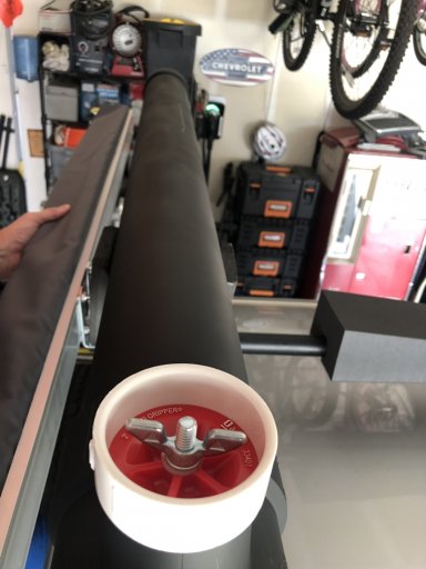

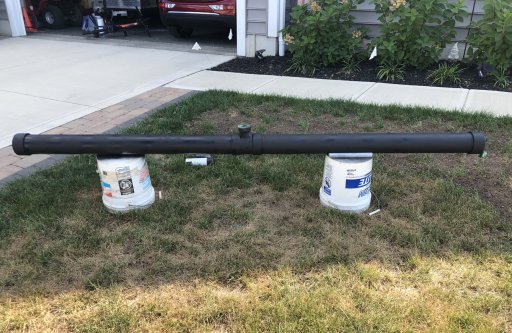

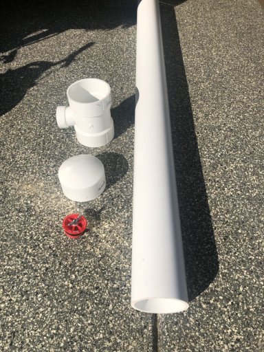

When we tent camp or Boondock with our T@G camper, we want to be able to shower with hot water. There are “professional” units made of aluminum for hundreds of dollars. There are also innumerable DIY options using plumbing supplies for less than $100. Here’s my project.
8 feet total length
5.5 gallon (US) capacity
Total cost under $100
Details of the build on IG @DocAndJojo
View attachment 111468View attachment 111469View attachment 111470View attachment 111471View attachment 111472View attachment 111474View attachment 111475View attachment 111476

Nice work. Curious as to why you just didn't go with black abs pipe though. Also, are you pressurizing it with a bike pump or on board air.

Good work, make sure your glue joints are good, I’ve read of some builds exploding when they get hot and pressurized bouncing down the trail. Looks like it was a fun and satisfying build
Thanks.
ABS pipe can leech chemicals into the water with heat and UV exposure.
Pressure can be hand pump, bike pump or in my case, PowerTank CO2 system.
I used a lot of glue - appreciate the pointer.
Won’t travel with it pressurized, only at base camp. That’s the purpose of the pressure release valve (relieve pressure before travel).

Your thread inspired me.... I had ABS, so I used it.using ABS, it is NOT safe to drink, but I don’t mind using it to shower or clean off equipment. It holds about 9.5 gallons
