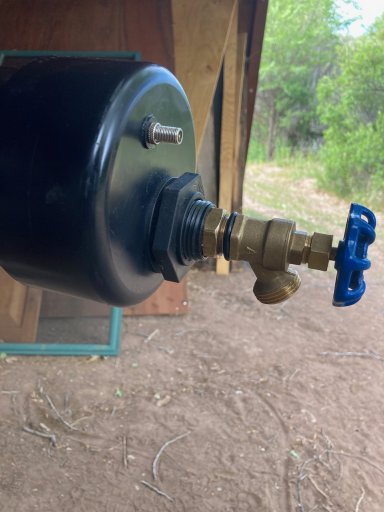

Nice. I added a boil head union because my spigot connect leaked on my original version (based on REI DIY)...Here's the new spigotIMG_3720.jpeg
