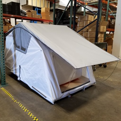

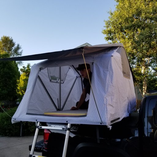

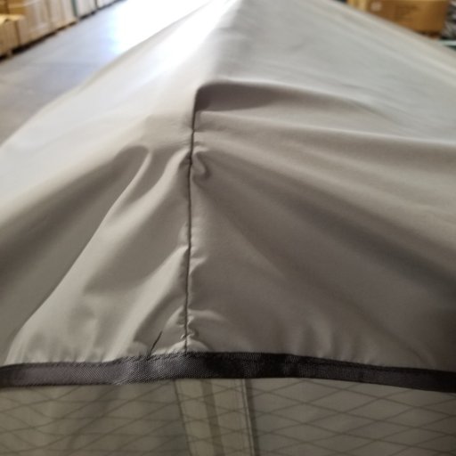

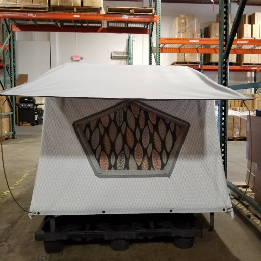

Crunch time... I sewed the windows and got the panels together. The fit is a bit tight on the long sides, but I have not put the 2 expansion slots on the side panels which are critical when you close it as they allow for geometry to change without ripping the fabric. So, I put the tent on for a quick fitting and for the most part, it's pretty sweet. Added a cool window shade for fun. The sewing part was not perfect and I could have done better had I spent a bit more time, but oh well. I will square it up tomorrow and post more pics. View attachment 58764View attachment 58765View attachment 58766

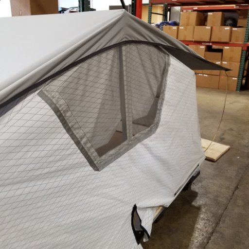

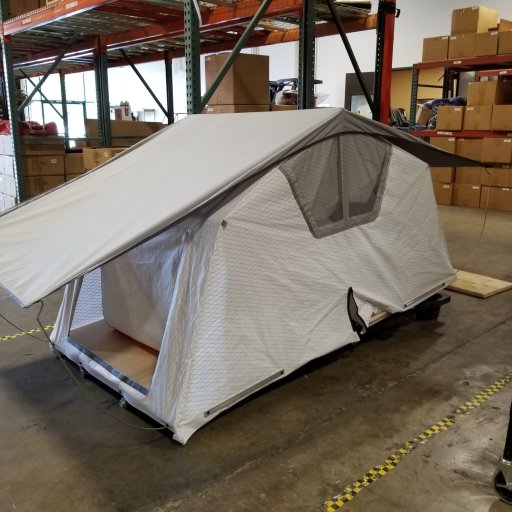

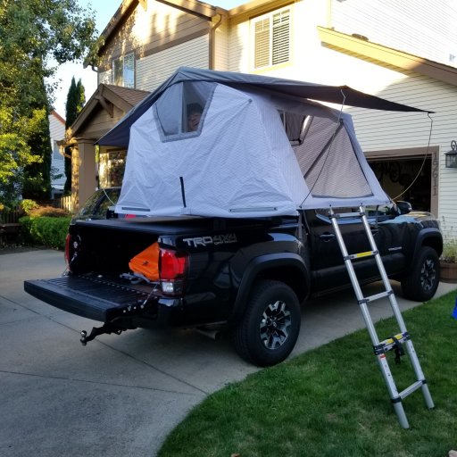

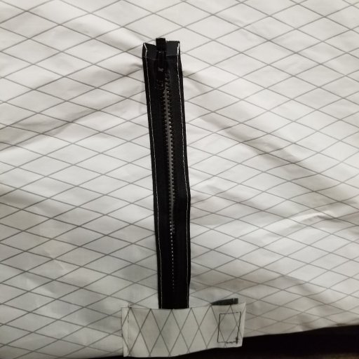

I was able to get some time in this weekend after traveling for 4 months solid. Since NWOR is this weekend, I figured I better get it done... Here is the last of it... Both fabric portions will need to be remade, but these will do for one weekend. For the main cabin, the pattern is a bit too tight still. I need to increase the long piece running end to end a bit, and widen it slightly as it is being pulled at the corners. This will fail eventually, so I need to be smarter on a side attachment and skirt. To allow for the fold of the tent, I slit the center at the bottom on both sides and installed zippers there. For now I used a cheesy little flap to hold that in place. I will also need to use stiffer plastic rails on the sides as one day in the sun already warped them a bit. I used aluminum on the sides and that seems to work well. Next, I cut the fly out of a waterproof breathable gore-tex material, but it is too narrow to make a proper fly without seam sealing, so that will be the next round after this trip. I bought the rods for the fly from CVT (8 ea for $50) - I am only using 4 for now. The windows got a little fun 'Tahiti' print for shades that attach on the inside. The fly is under a decent amount of tension and would work better if it covered the sides, but oh well. I'll risk some rain this time. I laminated a piece of memory foam to some urethane furniture foam and covered with a grey canvas. I used spray adhesive and then cut using a vertical fabric saw. I am spoiled having a lot of these tools but none if it is too hard with ordinary trips to Home Depot. Last, I made a waterproof orange cover for it out of 180z tarp vinyl, sewed crossing straps with 1" s/r buckles and then welded the corners seams to make it waterproof. It isn't too pretty but I'll make another with the new tent cabin later. Finally, I mounted it to the rusting Voodoo fab racks that I need to strip and have powder coated. 1 year old and they are rusting everywhere. Lame.
