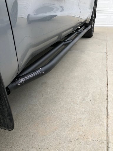

I’m not sure what kind of style your going for. My sliders are A very simple square tubing design with some supports to the body. Their website says they use 3/16” inner hitch steel. Which from what they say is the same steel made to use trailer hitches. So it’s stout. Iv lifted the vehicle from them. Iv slammed them with the full vehicle weight on rocks and what not. Not a single bend. From a cherokee forum, I believe there’s only one documented case of someone bending these. So I guess the 3/16 hitch steel is some sturdy stuff.
Mine are from Rocky road outfitters.
This is to show the design.
Reactions: Gabriel Bozeman

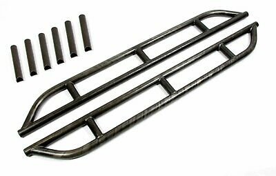

Really never heard of them? Austin and san antonio area have lots of rocks. There are alot of websites that sell premade sliders for your truck @ around $300 there are weld yourself kits starting at $99
