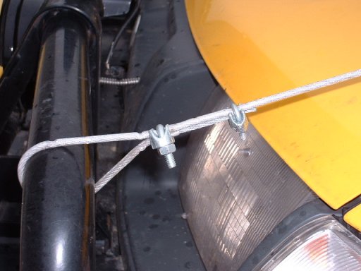

Oakley
21230
keep mine cheep and simple .. biggest down side is I should have used marine grade hardware as I needed to loosen the turn buckle to open the hood which is why I eventual stopped running them (well that and I got to the point where I cared less about body damage)
