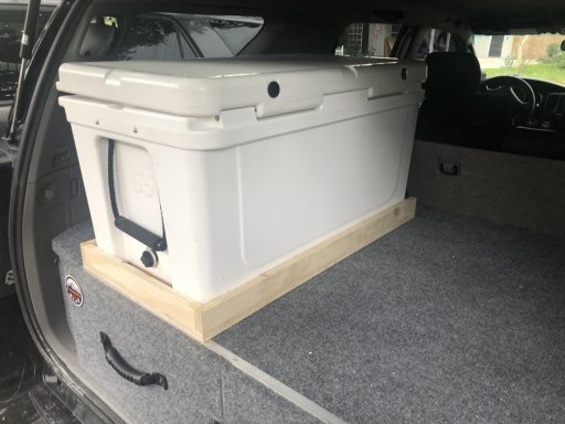

So I finished the drawer system and had some wood left over and have been playing around with designing a cooler slider as the fridge is out of the equation for now. I’m thinking about the upward force on the 3/4” ply wood when the cooler is completely slid out. I’m thinking of using some angle iron to attach slides onto. I would appreciate any input or thoughts on how to possibly go about making this thing “bulletproof” View attachment 137423View attachment 137424

You could probably reinforce the edges. If I was going to make my own I'd have it tilt down for easier access. My 5'1" wife can hardly see into my fridge and it's mounted in the bed of the truck. Not on drawers..

Been thinking about that option, will have to look into what other folks are doing for the tilt. Thanks
