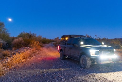

IMO @Wawa Skittletits has it 100% correct... ditch lighting needs to be driving, wide driving, or wide cornering or whatever your manufacturer of choice calls a light in the 30-45 degree range, ideally with a flat beam so the light is focused at road-level and not wasting light illuminating the ground, trees, and sky. Most critical is aiming them so the edge of the beam follows the edge of the hood which gives you actual corner lighting but more importantly, they keep light off the hood vs something like a flood or diffused light.
My lighting philosophy is pretty straightforward:
  • Bumper lights should be a 30-45 degree wide or wide/spot combo patterns and on top of the bumper is superior to fog-level lighting for driving lights if you want to avoid shadows. Lighting that can be dimmed will be appreciated by other drivers in your convoy or you can run some big lights along with some smaller lights for when following.
  • Fog lights are for fog and getting under dust and are not what you should rely on for driving lights.
  • Roof bars should be mostly spot pattern because the height gives you the best throw. Ideally, set them back a foot or so, allowing the roofline to be a gobo and again keep light off your hood.
  • Ditch lights cover your corners mounted as previously mentioned in a 30-45 degree pattern
  • Sideways lighting on either on a cab rack or the front of a bed rack cover your lateral lighting for scouting campsites and offshoot trails... again, 30-45 degree pattern and IMO as close to the B-pillar as possible so when you look out, you're right around the center of the light.
  • Diffused lights are for very slow maneuvers so basically rock lights and reverse. Also camp lights.

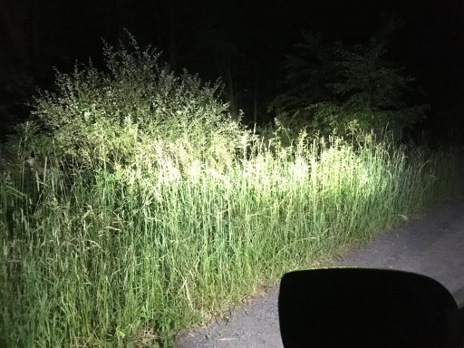

I agree and disagree I use mine on back roads to where I live and many many times these lights have allowed me to stop before a deer has jumped in front of my vehicle as I saw them running from the trees much earlier... That being said the first hint of car lights coming in the opposite direction the light goes off. I never just drive around with them blinding people
