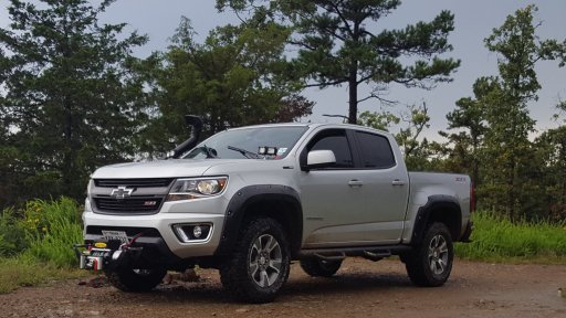

A beautiful day in Austin, put on the Thule Roof Rack, WeatherTec window visors, tie downs, and a pic of the decked system that got installed last weekend.

I have Colorado Bison in red crew cab. Can I ask, did you had to do any trimming or modification in order to fit the 33" tires in the front? Also, any odometer/on-board computer adjustment? Thank you very much for your reply!

Sorry forgot to mention, I am running the Rough Country GM Inline Speedometer Calibrator, that I also got through 589 fabrication. There is a minor correction needed with 33s
Aye, without the calibration module you would have to do some calculations to adjust for the tire diameter difference which isn't insignificant when going from the stock size to a true 33" tire. The multiplier I had to use going from a stock 255/65/17 to a 33" tire is 1.092. So 300 miles * 1.092 = 327.6 miles actual driven or for the diesel folks 500 miles * 1.092 = 546 miles actual driven. OEM tires on the ZR2 and Bison are a little larger so the multiplier is slightly smaller but you get the idea. :)

I think I understand the tire point, although...question about the Calibrator....does it have to be hook up at all times or it will simply do its thing somehow and you can unplug it? I am sorry, I am very new to this, I got the truck for my 50th bday, but I am lost in this "bigger tires/on-board computer re-calibrating" thing. Thank you

I was talking to the guy from dealership who sold me the truck (young kid 25) and he claims that the dealership can do this calibration if the bigger tires are put on. Do you think that is possible, I mean by the dealership?

I don't think that the Dealer can change the speedo for tire/gear change. You need a aftermarket device that plugs in the aldl. You can also use a aftermarket tune like the Trifecta to effect those changes. The Trifecta also improves the transmission shifting and can add HP and TQ. The tune has two modes, ECO and SPORT, ECO is basicly stock tuning with improved shift points and SPORT adds 10-15% hp/tq. Made a significant difference in my truck. That along with 4.10 gears are the best mods I have ever done short of hard core engine work.
