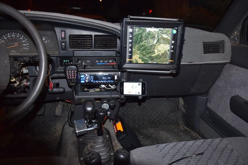

On my 1990 4runner, I just drilled a RAM base into the dash and called it good, no air bags to worry about and who care about putting holes in a dash that is already wrecked from 28 years of sun. I was pretty happy with this setup in my 90', and I still use it.
