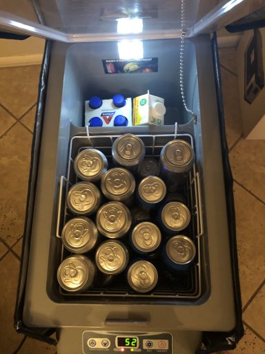

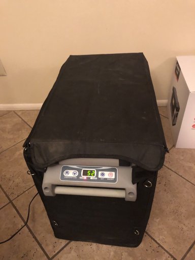

I purchased and have used on 3 occasions the Costway 54 Quart Refrigerator/Freezer and have found it quite competent. Today I received my order for the SAUOKI G500 Power bank/Inverter from amazon and am testing it with the Fridge.
The Fundamentals of the test:
The G500 was charged fully before the test.
The Fridge was loaded with 40+ cold beers, a 4-pack of meal replacement shakes and a carton of egg substitute.
The air temp at the beginning of the test was 76f and will not drop below 70f.
The Test:
The full Fridge was plugged into the G500 at 5:48pm on Thursday, November 15th 2018.
The set temp of the Fridge is 35f
At power up the interior temp of the Fridge was 64f
The compressor kicked on at 5:54pm
The interior temp of the Fridge reached the set temp at 6:04pm - 10 minute cool down

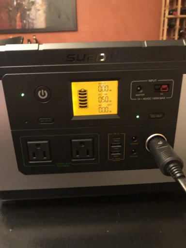

During initial cool-down the G500 indicated a DC power draw of 50w
The lid of the Fridge will be opened 2 times per hour for 5 seconds during waking hours to simulate use.
My goal is to determine the total run time for the Fridge powered only by the G500,
Updates to come....

Is that three days parked without moving? I just bought one of the Wynter fridges. I don’t think they are very efficient, paperwork says 5.5 amp draw.
Looking at the Costway website, the 54q draws 50 watts. 50/12=4.166 amps.

Simply take watt hours and divide by 12 and that will give you amp hours. ( they rate them in watt hours so you think your getting more for your money). 500whrs/12 volts = 41.66 amp hours. A cheap “deep cycle”marine battery from Walmart 135 amp hours (1620 whrs)costs $79.00.
