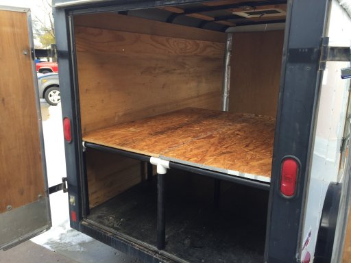

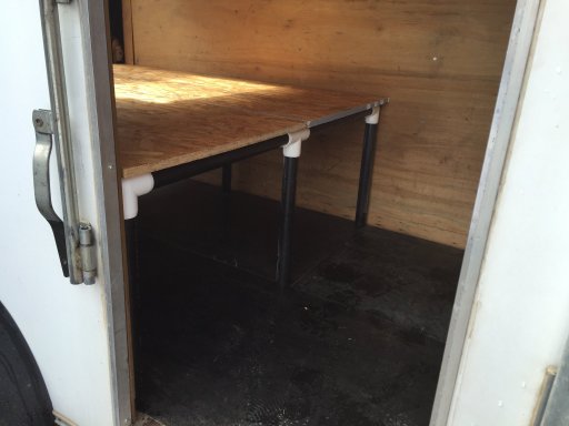

The first thing I did was to add a way to use it comfortably as a shelter. For this, I build a 9-post frame from heavy duty PVC (3", I believe) and 3/4" floor decking to use as a sleeping platform. It allows us to load up camping gear under the platform and keep some bedding already setup on the platform. If I ever need the cargo space, the platform disassembles and comes out entirely. So far, it's worked pretty well but I have a couple things to tweak, such as a tie-down system so it doesn't move around on gnarly trails. $70 for the whole thing.

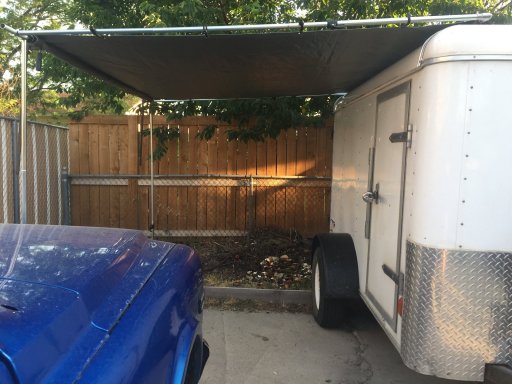

The second thing I've added is a 8' x 9' awning that I built with a few telescoping tent poles and some hardware store supplies. The awning rolls up as one unit and stores nicely inside the trailer so it won't get caught on things and create more wind resistance. When I get to camp, I just roll it out and secure it to the quick fists on the roof of the trailer and I'm good to go. $100 for the awning.
