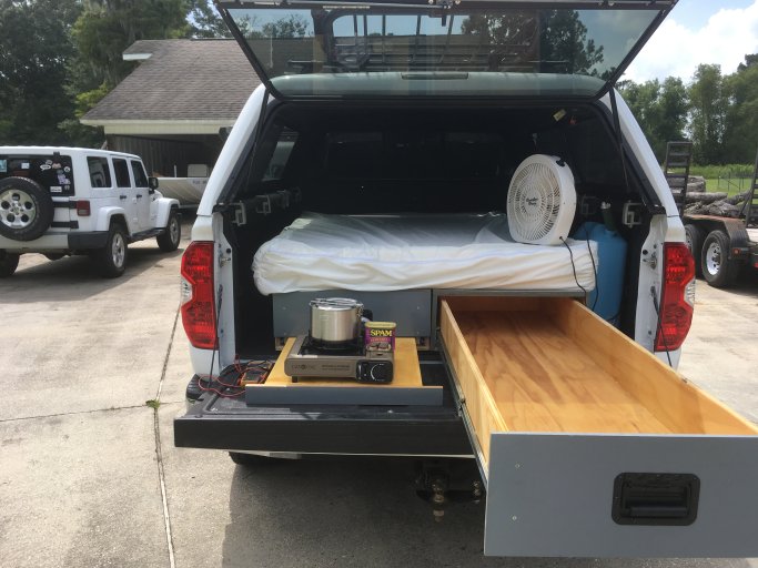

ive built several...back of my Tundra, back of wife's jeep, inside converted cargo trailer, etc...
the pic shown is a 6' deck system I built for the Tundra using 3/4 birch plywood (Home Depot version, not a furniture grade plywood with more veneer layers) and I went with full 6 foot slides, which cost more than all the other components combined. the weight is insane, so I made the system into two separate pieces so I could take it out by myself.
when not camping, I use the deck system to carry tools and stuff like that, so I really need it to be robust...3/4 plywood is definite overkill, but it works for me. I also fiberglassed the top of the boxes because other than having a soft mattress on top of them...I also carry bags of concrete, bricks, metal, etc and the fiberglass top is the only thing durable enough. I tried 2 part epoxy and plastic sheet veneer, but they didn't hold up to the abuse.
for the sequoia, similar to the jeep design, I would go with 1/2 plywood and make it modular. maybe start with a frame that is custom made to fit exactly like you want with re-enforced areas to mount your tie downs. for assembly, I would use a good construction grade polyurethane adhesive like Gorilla construction adhesive found at Lowes, Home Depot and a cabinet mounting screw that is skinny with a big head. the skinny shank wont split the plywood and the wide head has really good holding power for something that will be bouncing around a lot. Pilot the top piece of plywood so that the screw doesn't split the plywood since you will be working so close to the edge. with plywood, you will be attaching to the end grain of the plywood, so that is why I like the polyurethane adhesive with the cabinet screws. for the frame, you could go with solid oak 1x3 or similar or just cut strips of plywood and use that to make your frame...both are good options and plywood one is a bit cheaper. then I would make "boxes" that fit in the frame. maybe do a slide out for the stove with a slide out under that for a table to work off of while cooking. go on Pinterest and look at some of the designs on there...lots of good ideas you can combine to fit your exact needs.
1/2 birch is fine. good price wise and is strong and durable and about as lightweight as you're going to get without getting into a foam laminate.
I like the frame with modular inserts so that you can remove parts and make changes without having to redo everything. you can also use aluminium diamond plate for the top...looks good and is very durable.
for me, the design was easy...go as big as possible and as strong as possible. I've had the deck system for 4-5 years and have done desert camping with it along with using it for a lot of construction work carrying tools and materials. I built it like a tank and spent the extra money on the big slides and haven't regretted a thing. it gets used daily and turned out to be an investment for me.
I did a build out for my cargo trailer and it has a good bit of modular design and maybe a few good ideas that you can use. here is the link to the build thread I posted on here...modular build out
