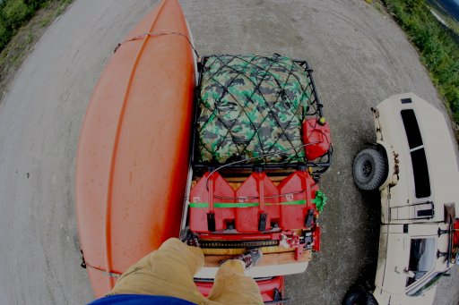

Sceptre water and gas cans. They work in every climate, in most every condition I can think of where you would need gas or water, most NATO militaries use them or something similar. They have never failed me. I do like them better than metal cans and seem to hold up to more abuse. Bullet holes or punctures can be easily plugged and patched up on the trail or road. They are not cheap but in my opinion they are worth the money.
