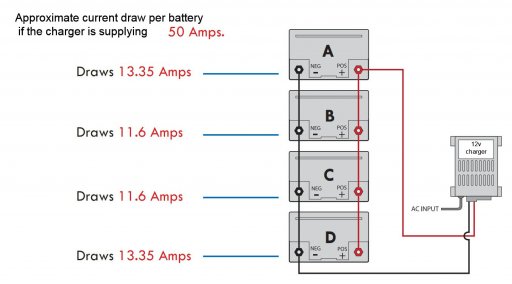

Figure 1 below depicts how most of us connect a bank of batteries. But, this results in an (electrically) unbalanced system due to uneven resistances in the wiring and connections.
The first battery in this configuration will receive a higher (faster) charge than the others and be worked harder under load than the next one and subsequent batteries.
Theoretically, each battery will charge and discharge at the same rate (i.e. current flow), but this is not the case in reality. Small, but measurable, differences in resistance between each battery connection reduces the current flow through each of those connections as shown in figure 2.
Balanced charging is the way to eliminate these differences by evenly distributing the resistance of the connections across all of the batteries. Doing this allows for balanced charge and discharge, therefore gaining the best life potential from each battery and ensuring they all have a similar, longer, lifespan.

The simplest way of achieving balanced charging is to connect from each end of a bank of batteries. In the example below, each battery will draw current through exactly the same number of connections. This is a far better method than demonstrated in the two examples given in Unbalanced Charging above. While a difference still exists (approx. 15%), it’s much less of a difference than before. However, this is still not perfectly balanced.
This method of charging can be used on both an even and odd number of batteries.
Perfect Balanced Charging
As well as looking to make sure each battery is charged through the same number of connections, what is also important, is that each connection is identical to the next. i.e. the wire gauge and lengths are identical. This is important (especially wire gauge) to ensure that the resistance of each connection is the same throughout the system.
Note, the drawing above is a schematic, making it look like the negative connection from the charger is longer than the positive – this is not the case, they should be the same length.
Likewise, the connections between each battery should also be identical lengths. And to re-state, they should all be the same gauge.
This method of charging will ensure that each battery draws the same amount of current from the charger, therefore maximising the life of each battery because they charge and discharge at the same rate as each other.
