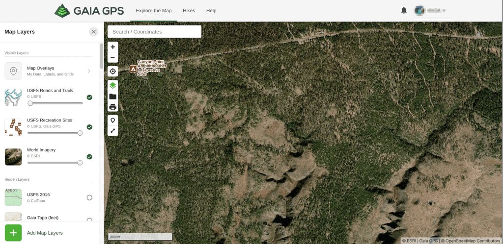

Received a potential solution for you @Booboodmb...
Apparently in a recent app update they separated routes and tracks in the map overlay. The solution is to tap the Layers icon, tap Map Overlay, and toggle on routes. I don't know why they did this change but once you do that a simple restart of the app will hopefully take care of your issue.
That was it! Thanks!!!!

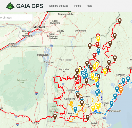

I have another.. Here I've learned to make folders from my routes to tracks. I do like this and what's possible going the way! What I do/don't see is two part.
First is: When I open the folder I get just those tracks/routes, but none of my waypoints..
Second is: When I click for full screen I gat my waypoints, but I get all my waypoints and routes/tracks..
There's probably a tutorial on it out there somewhere.. Can you hook a brother up to it?
Lower coastal is the run I'm working with. Upper red is another's route I'm reviewing and not in the folder.. rather I wasn't showing.
This is how crazy my NH map now looks in full screen.. Has to be a way to hide routes/tracks.
I’m on my phone so I will cleanup the massive quote later.
Are your waypoints in the same folder?
You can toggle on and off your tracks etc in the left Toolbar above the map layers you have selected. This should turn off the unrelated tracks and still show the data from the folder you are in.
If I am misunderstanding what you are asking I will just have to review this later.
In the mobile apps you can individually toggle specific tracks on and off.
Hmm.. I doubt the waypoints are in the folder especially if I have to put them there. I assumed that if you made waypoints while making a route they would be part of.. So, haven't a clue if they are...
Toggle on or off makes all the waypoints disappear, including the ones I want.. Tried messing with a few on/offs.
Hmm.. If you can turn on and off tracks on the mobile, then I should be able to on my laptop. At least ya'd think so.
I'm working on my laptop for ease and screen size. I'm heading out in a bit and will play a bit with my mobile and see is I can on that.
Every time you add a waypoint on your mobile device it will ask you what folder to put it in. Once you change the folder future waypoints should default to that same folder. I am not sure about the online version.

Gets a bit tougher on the online version, yet found it again with your help. Once the waypoint is created, I clicked details and from there you get the opportunity to place it in a folder!
Whoa! One part worked out.
