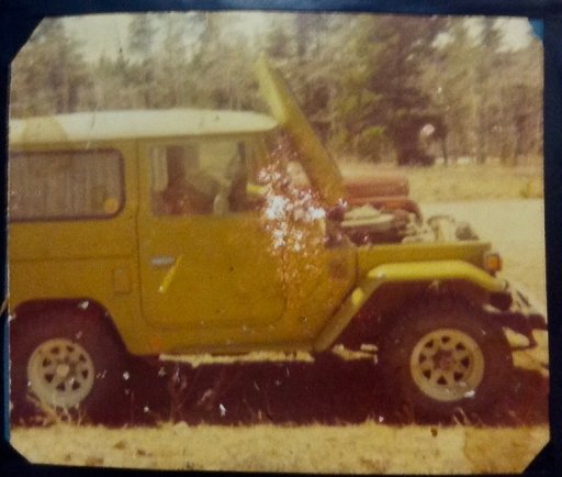

I'm a bit late to the party here, but have read all of the posts with amusement. What choice did the OP make? Steel or aluminum alloy? Oh no one mentioned the vast differences between cast alloy and forged alloy. If I had more money than I knew what to do with I'd be running forged alloys. As it is I have always run with the stock wheels on every vehicle I have ever owned except my first Landcruiser, circa 1976. Some things the engineering departments get right and drive train to rubber is usually one of those things. However back then in my testosterone induced stupidity I put on a set of counterfeit "Jackman" steel wheels. The real Jackman's had welded iron spokes. The knock offs I bought were stamped and nearly impossible to balance. and ended up denting very easily. Again, a huge difference, even between steel wheels. Wider tires, wider stance =s more stability? The difference is just not really noticeable unless you are hard core rock crawling or street racing. Do wider tires look cool? I'd say yes, as long as they are kept tucked up under the fenders. Anything sticking out just looks like a bad idea gone awry. I've had skinny and I've had as large as I do now, 285/75/16s. Anything larger than that my drive train would have pooped out on me a hundred thousand miles or so ago. I posted a while back about starting up a mechanical advisory thread as many of us have been doing this thing for a lifetime, and I know that I have made plenty of mistakes along the way, (sans, cheap steel wheels on my first 40 series, etc etc etc etc).... In the end , bigger wider tires, may look cool, give you an imperceivable amount of stability (do the geometry) and will cost you big bucks for ever and ever as everything in your drivetrain will wear out prematurely. So Hey there OP. What did you end up spending your hard earned dollars on? Cast alloy? Forged alloy? Stamped steel, or welded steel? Just curious. Peace out !! photo.jpg
