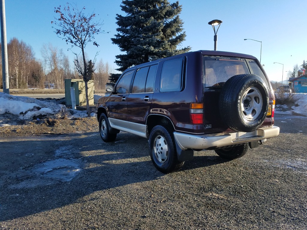

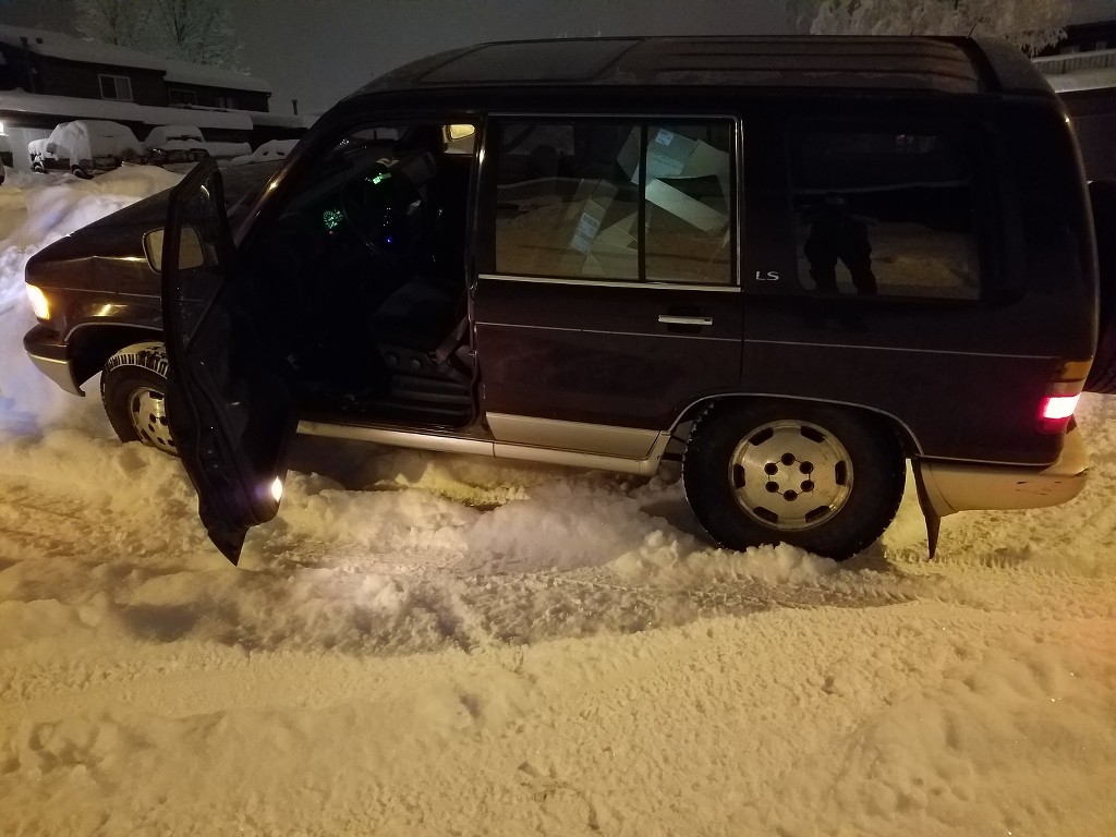

A few months ago I picked up this 1993 Isuzu Trooper LS with the intent of making it an overlanding rig to take my wife and I all around Alaska this summer.
Pics!, its why we come here right?

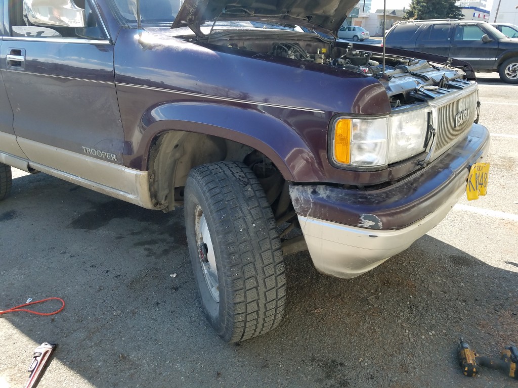

When I brought it home for the low low price of $750

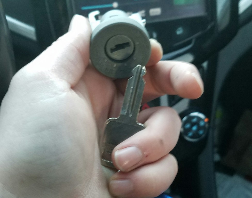

I spent the first couple Days fixing little stuff like the broken key in the ignition I have since broken 4 more keys, I need a solution.

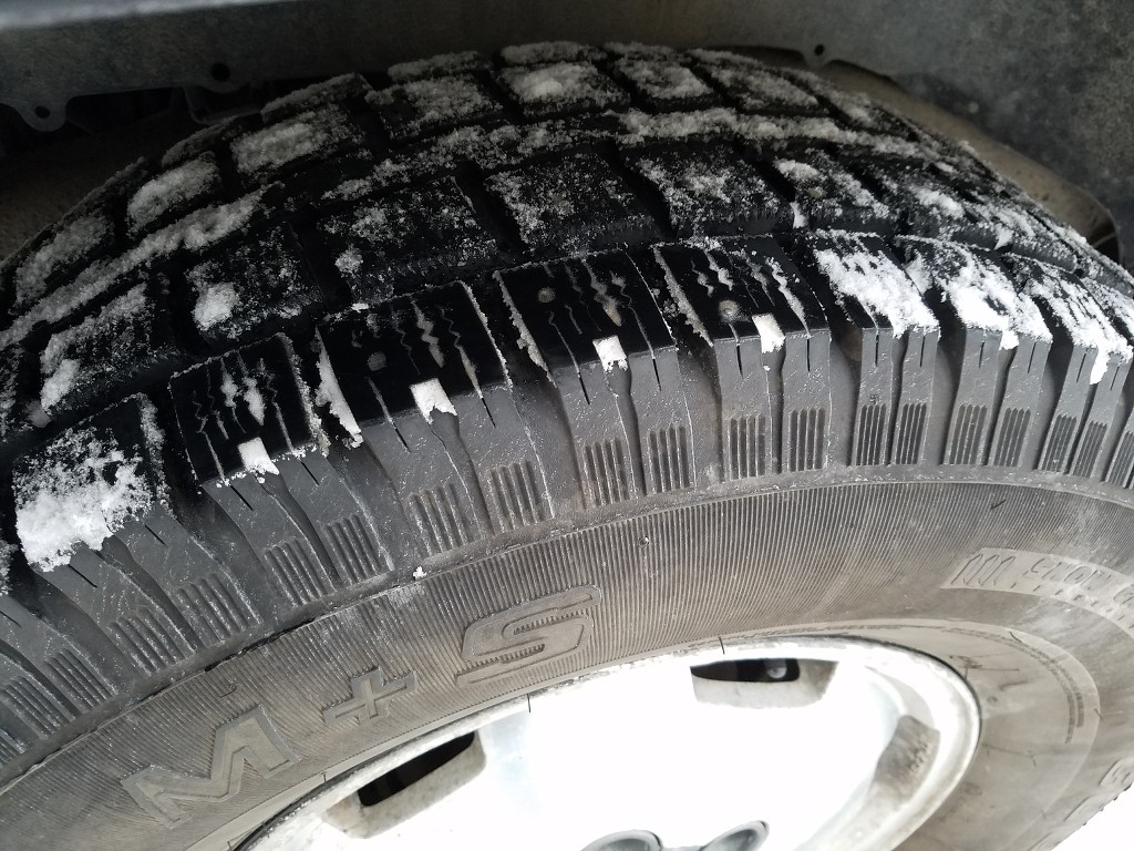

I found a steal on a set of 265/75/16s for $150. they look almost new.

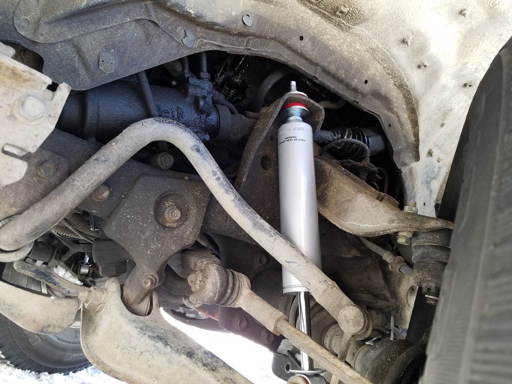

3" lift recipe, add one set of 782 ( might change to 784) coils, 1.5" daystar ram 1500 coil spacers, ball joint spacers and new shocks.
This is sadly the only pic I have in process, I was working by myself in a bit of a time crunch.
you can see how much Higher in the rear it is.
Decided to flex it out a bit
The rear wasnt even flexed all the way, I think the truck would have tipped before it maxed out.
When I did the lift I installed rancho rs5144 shocks in the rear. Then I put skyjacker m9552 in the front.

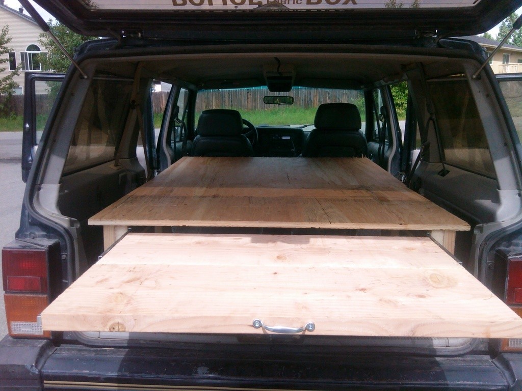

And before too long, a sleeping platform for the back. I have a few ideas and a rough plan, its going to be heavy but it will hold up better than my last attempt, this time it will be METAL.
There was an earthquake.... and my wife and I broke it.. yeah... earthquake..

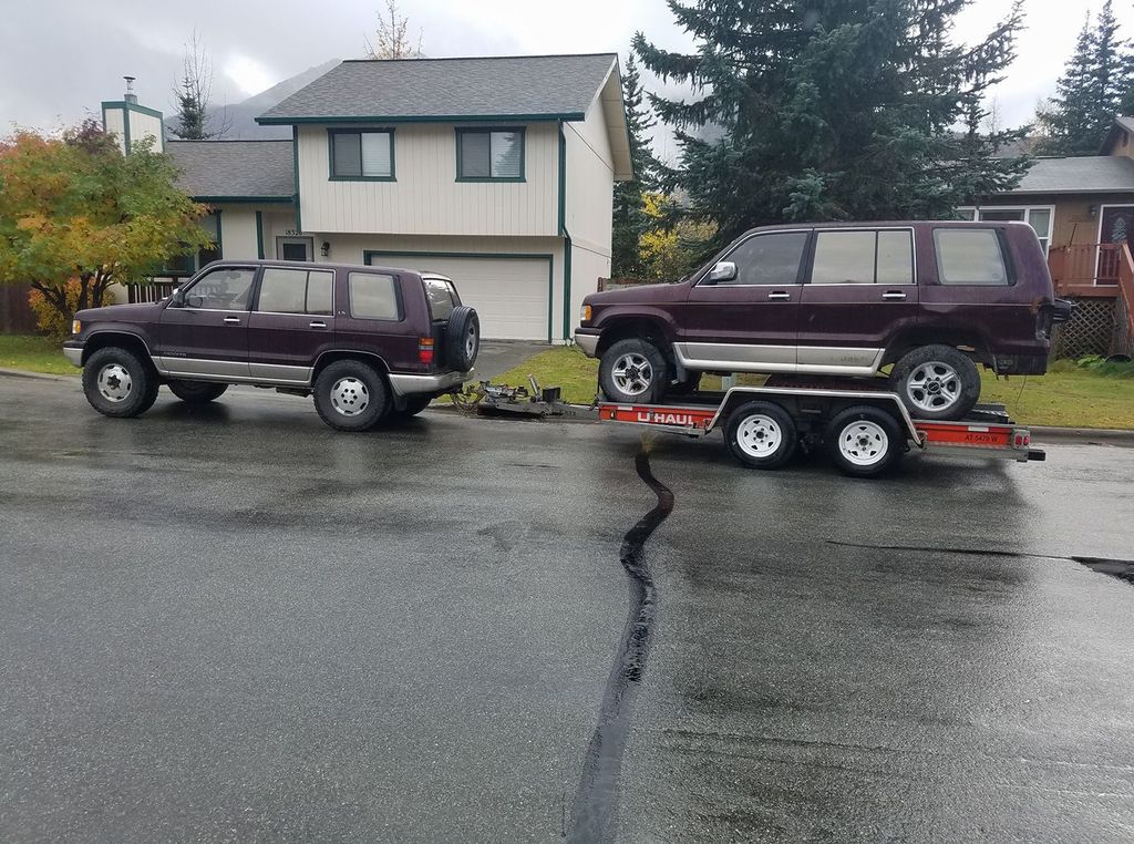

I bought a near identical parts truck, so this
is now this!!
not a huge change but it makes me so happy.

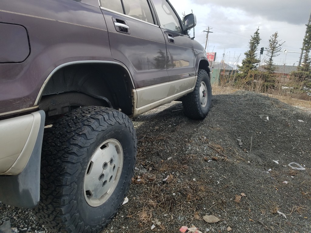

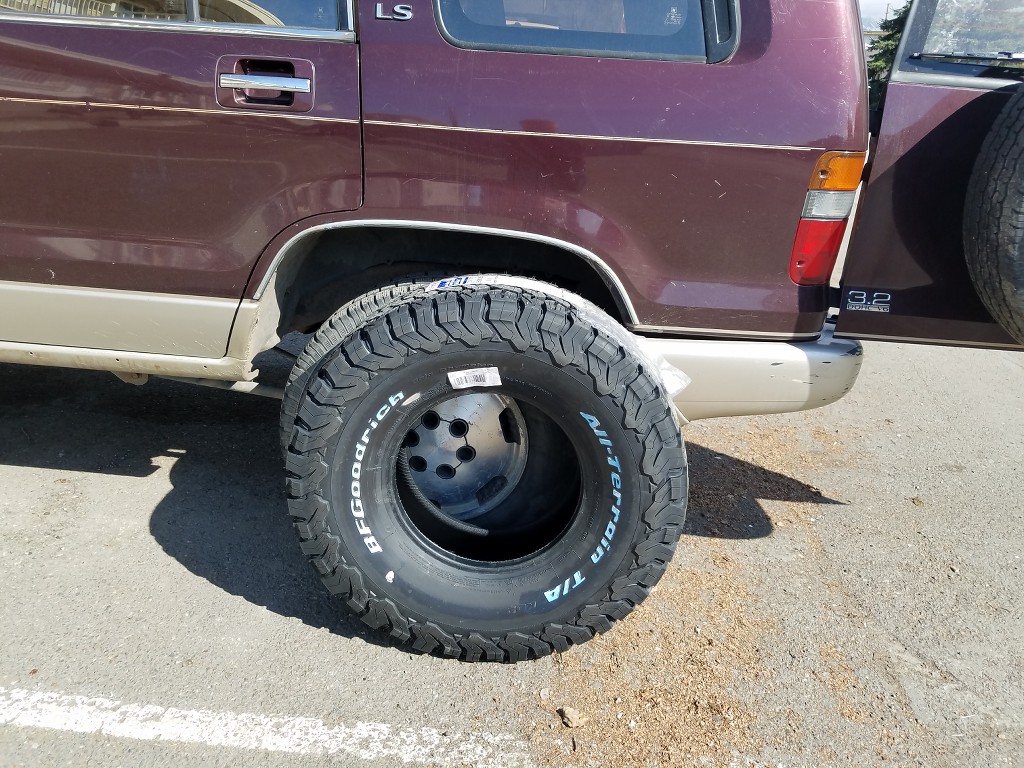

Oh wait.. I also ordered a set of 295/76/16 BFG KO2 tires and some 2" wheel spacers. guess thats kinda important right?
Got quite a bit done in the last few days.

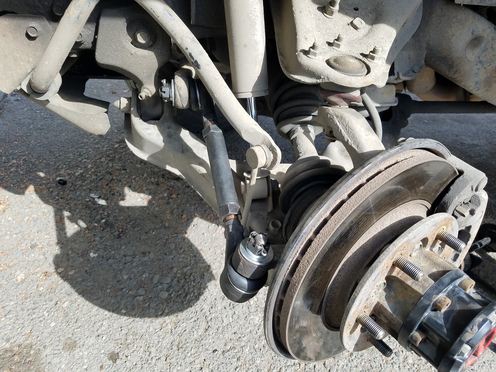

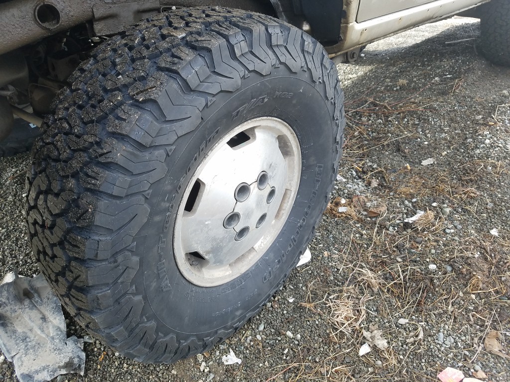

Installed some HD tie rods to handle the force of the larger tires.

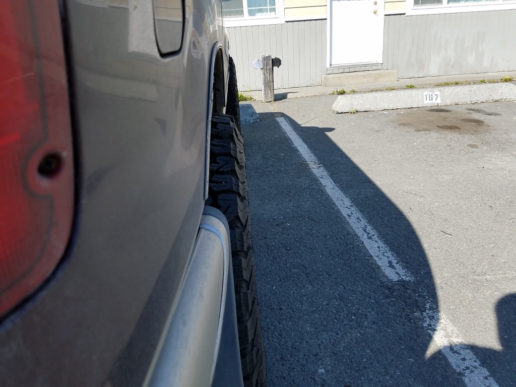

295/75R16 BFG ATKO2 on factory wheels. it has 265/75R16 in this pic.
They tuck pretty good. lots of clearance.
Got an alignment and did a few tune up items. I bought a set of NGK spark plug wires and matching copper core plugs. Made a really big difference.

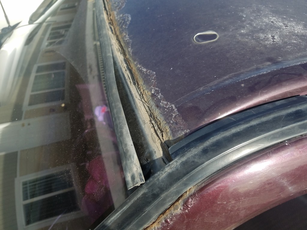

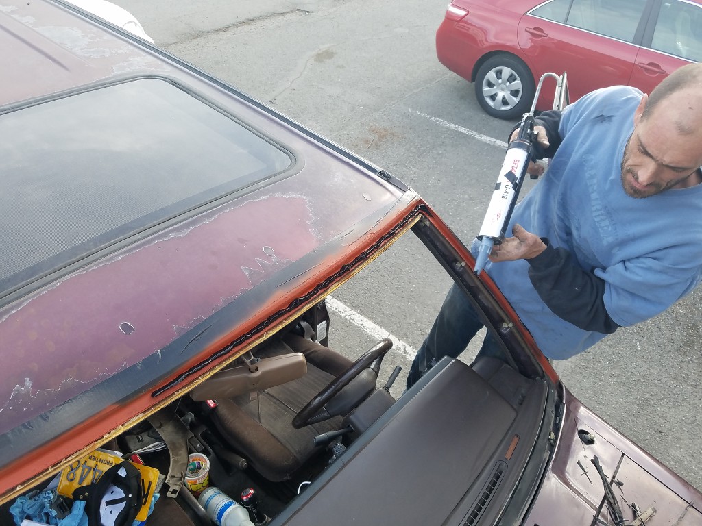

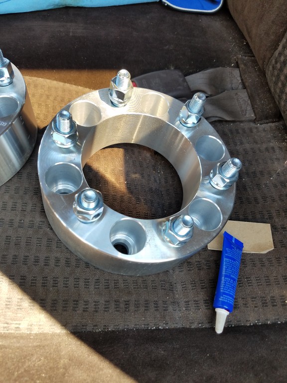

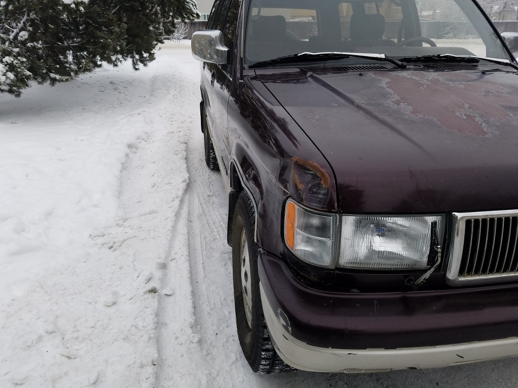

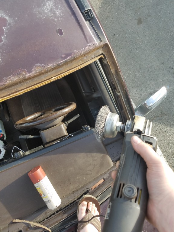

So since my last update, I installed 2" wheel spacers and Fixed the windshield leak/rust
ALWAYS USE PROPER FOOTWEAR..... thankfully there was no rust through.
Little filler primer, and some fresh glue all told for removal and re installation I'm out a mere $40.

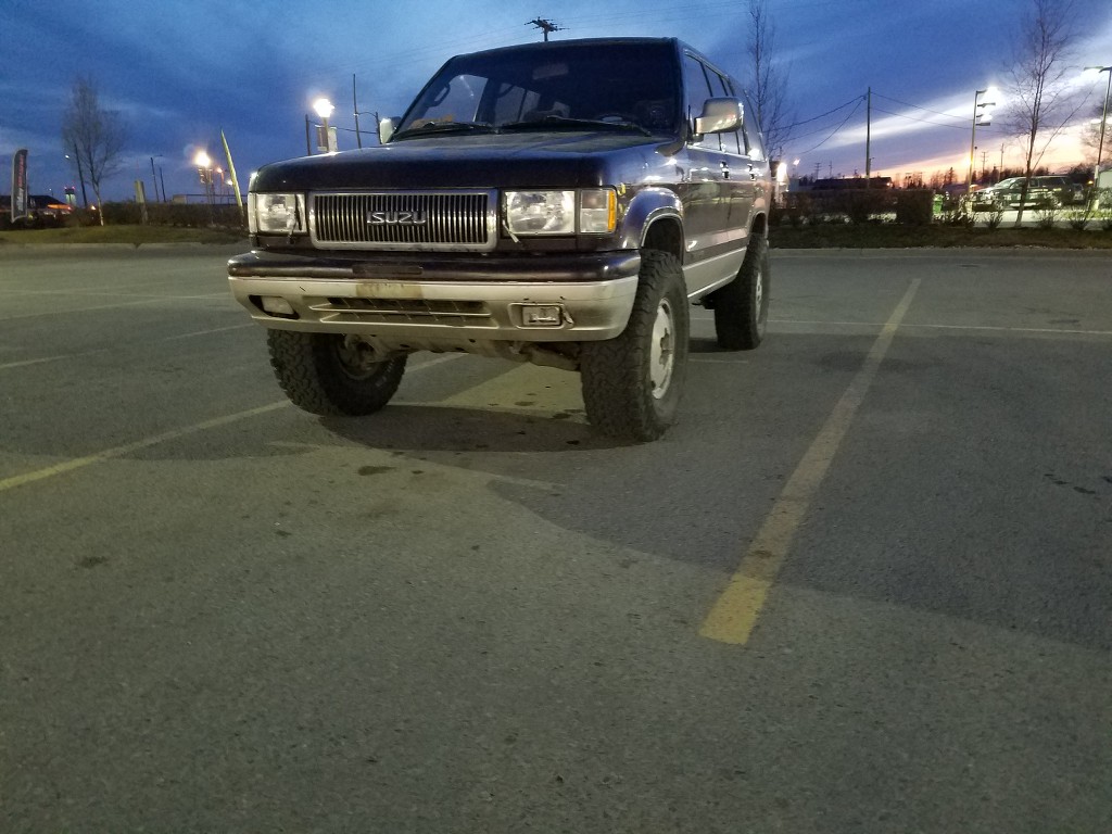

And here's how she looks for now, gettin there!
