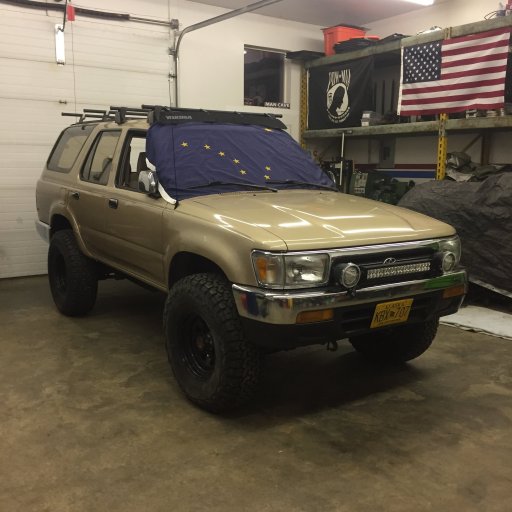

Hey all.
Wanted to start a thread that documented my new build.
Specs:
1995 sr5 4runner 4x4
Sierra Beige Metallic, tan cloth interior
3.0 3vze, 5speed r150 transmission
4.56 factory gears, OEM Toyota tow package
I lucked into this 4runner that had been sitting in a buddy's yard for six years. He had picked it up due to its immaculate nature, knowing that someday he would build it into a super clean daily. I convinced him to pawn it off on me for $2000 with a locked up 3.0 and plenty of filth. I wanted this build to be simple, fairly cheap, and to extend the lifespan of the motor and chassis with tasteful modifications that would give me more peace of mind on extended trips and off-road.

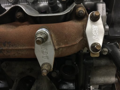

Cat delete (lc engineering)
Chrome delete
EGR delete (lc engineering)

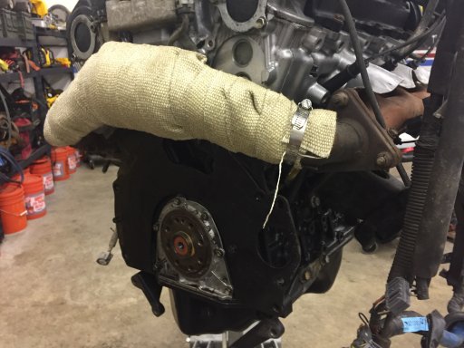

Wrap crossover manifold with heat wrap

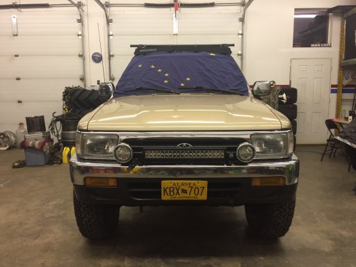

Vision X 9004 bulbs
Vision X 4.5" LED fog lamps

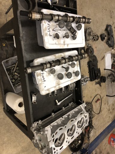

After being a 22re guy for my previous life, I am looking forward to getting into the increased tourqe, HP, and smoothness that comes out of these motors. I know that the 3.0 isn't ideal, but with the gearing and on 33's it should be much faster than my 22re on 30's. A few tricks and common sense stuff into the motor build (new head studs, remanned/tanked heads, wrapping cross over exhaust) gives me some peace of mind that I should have a long life with the motor. Eventually, I will pull the motor (running, hopefully) and swap in a 3.4 Taco motor. Until then, 3.0 it is.
The torsion bars were fully cranked as it sat, so I completely relaxed them. I wanted a comfortable highway ride, and with them maxed out you couldn't even flex the front suspension, not sure how the PO drove it at all.

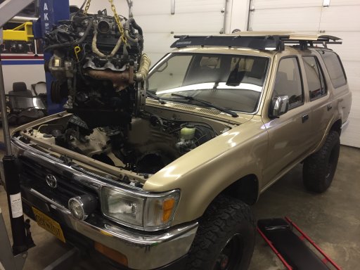

I'll put up all the pictures I have until now, currently the last things happening are the shocks going in front and rear, then it will be purely motor build, hopefully turning it over initially sometime in the next week. Once it's running first stop is an alignment, and she should be good to go.

This is how it looked when we made the deal:
View attachment 39460 View attachment 39457 View attachment 39456
It came with little history besides a local school teacher owning it for some time. Besides the years of crud that had accumulated it was in remarkable shape.
After it was cleaned up initially:
View attachment 39470 View attachment 39471
Pulled off the stupid side steps and chrome trim:
View attachment 39476 View attachment 39477

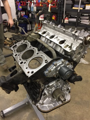

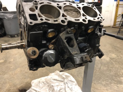

how did you get dual filters on the block?
The mounting surface under the oil cooler is exactly the same as the oil filter. Save a filter bung from an old block and screw it in, tap and plug the line coming off the base of the water pump and good to go. Another hole above the filter on the side of the block gets a plug as well.

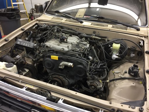

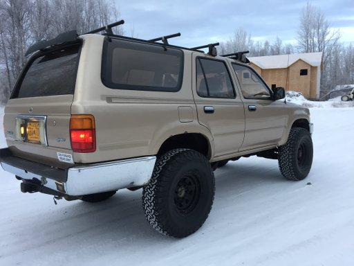

Well, its been a little bit so time for a quick update. The build wrapped up a few weeks ago, fighting the dreaded 52 engine code (knock sensor) which basically throws the engine into limp mode, killing performance and mileage. Intermittent, but there. So back into the shop to figure out the source of that. But without the code, the truck runs phenomenal, def. more power than the 22re, and smoother. Super happy with the 33x10.5 k02's, even with an open diff in the rear I have had no issues with icy starts and obnoxious wheel spin. After coming out of the pickup, the cab of the runner is super roomy, and quiet! The cat delete lets loose a nice rumble at idle but quiets out when you get on the gas. The new KYB shocks give a nice responsive ride, and the rear Moog springs help things out too. Adjusted the torsions to a 1/2 inch lower than the front, and it should handle the weight of camping gear nicely and still give an even ride. No really great pictures yet, but ill post up what I have. More pictures to come when shes road ready.
View attachment 43150 View attachment 43151 View attachment 43152 View attachment 43153 View attachment 43156 View attachment 43155 View attachment 43157 View attachment 43158 View attachment 43159 View attachment 43160 View attachment 43161 View attachment 43162 View attachment 43163 View attachment 43164
alaskan.lad
1,721
Palmer, Alaska
Gabe
Hurt
6503
Still running some tweaks on everything. Things needed addressing:
change the fuel filter (we didn't do this and I think it may have something to do with lack of performance and mild hesitation)
new pads and drivers caliper
diagnose the knock sensor, did a relocate onto the intake manifold but I think the sending wire has a break and is causing 52 code
heater control light fix
drivers courtesy light fix
mystery oil leaks
possibly new o2 sensor (doner motor had HG issues and possibly fouled the sensor, no light)
possibly new TPS sensor (once again maybe not)
I had a real bad idle and upon inspection, we forgot to put the hose on the PCV valve (this solved a lot of the original performance issues)
Did the first oil change at 300 miles, probably do another one at 1000 then let her go for awhile. Went to the Toyota dealership and picked up the last blank key they had on the shelf but they couldn't cut it because they are phasing out the older vehicle programs on their machine. Got the master code and had a local keysmith cut it, plus I got the test key from there so I have three keys. The k02s are awesome, I have zero complaints with the tread, though I might have bitten off too much with the size. I am contemplating going down to 31x10.5x15 Toyo Mts come summer on OEM SR5 rims, I just have a soft spot for those rims and happen to have a set that came with the runner, plus I have a set of gold-lettered Toyota hubcaps for those rims and that is reason enough.

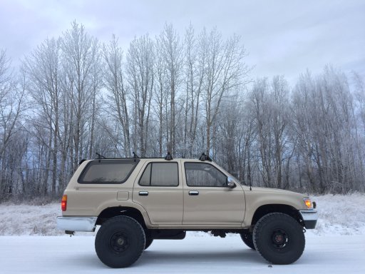

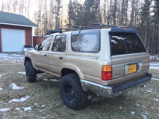

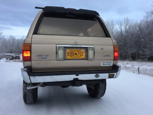

Some fresh pictures with the old ride for reference, shes officially off the insurance and going to her new home today or tomorrow.
(30x9.5x15, no front lift, rear helper springs, Bilstein stock height shocks VS. 33x10.5x15, front 1.5" BJ spacers/diff drop rear 1.5" spring spacer, new stock height Moog springs, front KYB +2 shocks, rear KYB stock height shocks with TG perch relocate 2 3/4" higher). Fender height on goldy is about 1" higher.
I'll try to break out the nice camera and take some more shots of the interior and motor in a few days. Thanks for reading ya'll, happy trails for you in the new year!

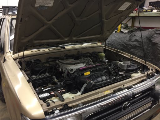

Fuel filter swapped out for a Napa brand, the filter looked to be OEM but was stamped with a big 98 so I am assuming maybe it was changed then. Either way after 20 years she was probably due for a fresh one. Also new Denso o2 sensor, and new (used) ignition coil module. Between those three things, I cleared all the codes that were coming up sporadically, and finally got the power band to a place where it wasn't doggy and cutting out under any type of normal acceleration. Filled up the tank and advanced the timing to between 11-13 degrees, and that woke the motor up! Really thrilled with the way it heads through the gears, not fast by any means, but steady acceleration through all the gears which is really the only thing I wanted.
Snowed 3+ inches today so I got a chance to drop it into 4x4, the ko2's that were great in 2x4 came to life. No issues and the motor was able to turn all four wheels nicely without needing to rev super high to shift. About 2650-2800 seems ideal. Last little bit of plastic I needed to trim in the passenger front wheel well has eliminated any rubbing.
Tentatively close to being able to say I trust it, need to put a few thousand on it and see how everything settles in.
Things that are minor that are bugging me but not a big deal:
4x4 light doesn't come on when engaged (I heard somewhere I think that deleting the ADD system has something to do with this)
Heater control lightbulb out (not a big deal because I have the cluster memorized at this point and don't need the extra light)
Courtesy door bulb is out (changed the bulb, didn't solve it, guessing it is in the harness inside the door card)
