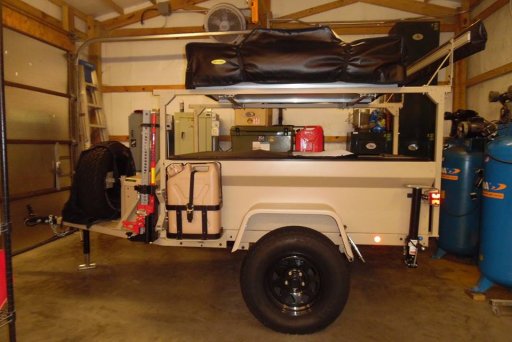

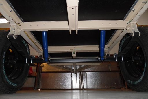

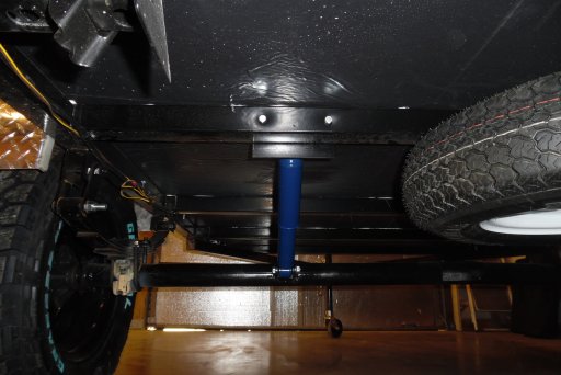

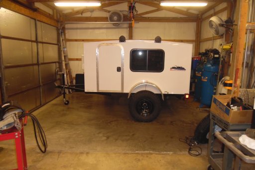

No I do not air down my trailer tires, on my Dinoot M Series adventure trailer I installed shocks (1st 2 pic's) I run 45lbs in General Grabber AT 2 215x75Rx15" , or my current new built Runaway Range Runner I just finished the suspension & install shocks also to this square drop trailer today (last 2 pic's) I run 45lbs in General Grabber ATX 235x75Rx15. I see no need to "for me" this will help to manage the axle spring movement & providing a smoother ride on those dirt roads & trails.
I carry a portable on-board compressor for deflate & inflate for my truck tire 265x75Rx16 Cooper AT Discorvery 2's
View attachment 94502View attachment 94503View attachment 94504View attachment 94505View attachment 94506
