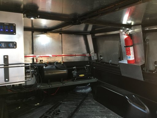

This is the setup a guy had who helped me reinflate a tire after fixing a flat. He said he just uses the inverter that came with the truck and has no issues. Filled up my 31" tire from zero to 20 psi in just a few minutes. He said he loves it because he can run air tools off it, fills tires fast.

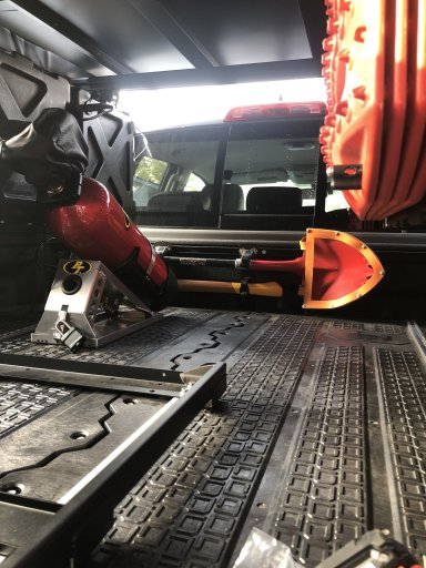

Powertank...easy peezy. View attachment 226598
Honestly I love the simplicity of the powertank. What I don't like is the cost and the fill up fee during the winter we had to fill the tank twice for just two vehicles. Granted we were up in the snow aired down a lot. One disadvantage to running larger tires I guess
