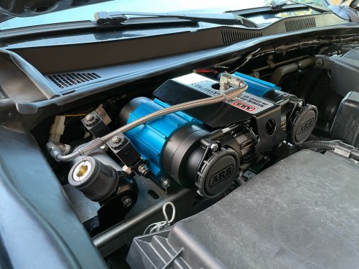

Personally I use the ARB dual compressor. We air up our 33’s in no time. And I’m not sure a of pump that can do a better CFM, or is as reliable as the ARB.

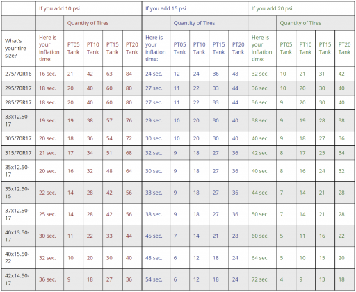

I suppose it all depends on what pressures you run. Some folks are running 35"s and only running 32psi and only air down to say 18psi, others might be running 80psi on the street and go down to say 25psi so that's a big difference. I have 10lbs Powertanks in addition to the compressors I mentioned above, and they are definitely way faster. With my WJ it was just a matter of seconds to go from around 18psi to 45. I haven't used one on my truck yet. Either way, I think 30 35" tires from one charge is optimistic. Here are charts from Powertanks:
So, with a 10lbs tank with a 35x12.5-17" if you're only adding 10psi (say 25-35psi) yes you should get ~30. However, if you're adding 20psi that drops to 16.
-TJ
Thanks for the clarification. It is all about the volume and change in pressure. Great chart!
