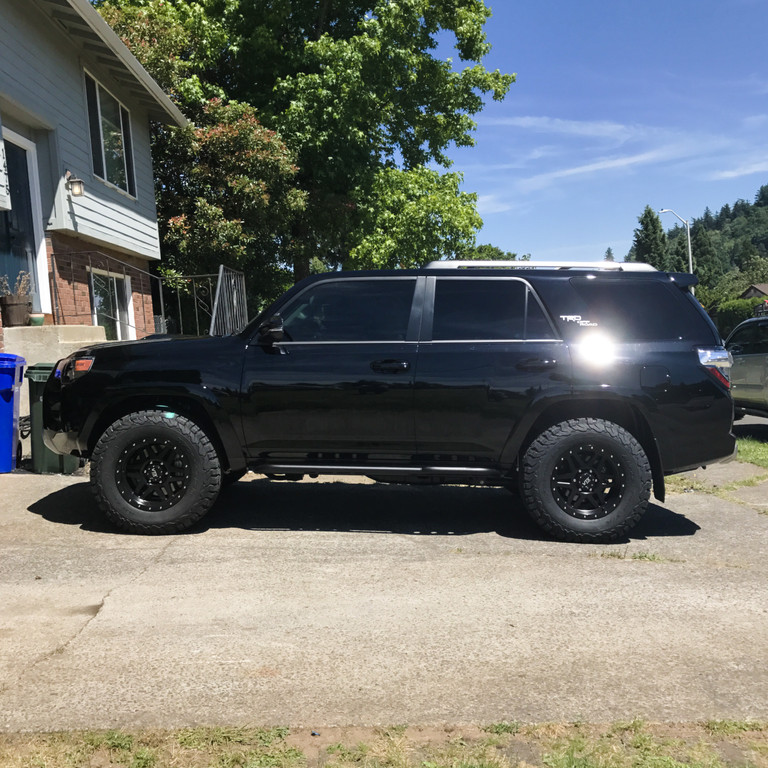

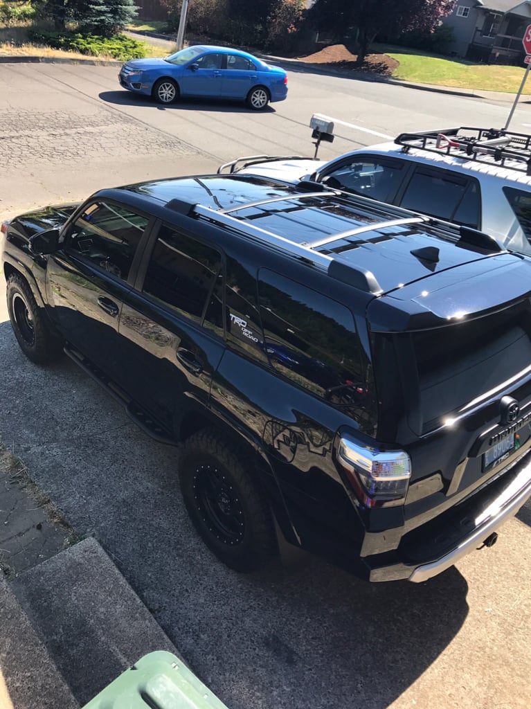

Sliders look good. I have the sdhq sliders the drivers side were a mofo because of the gas tank. How was the install on the 4 runner?
A10MileHusker
1,798
West Slope, OR
3628
Piece of cake. No cutting or drilling or awkward maneuvers. 6 bolts each side and didn't have to go around the frame or anything.
I also don't have KDSS so that made it easier.

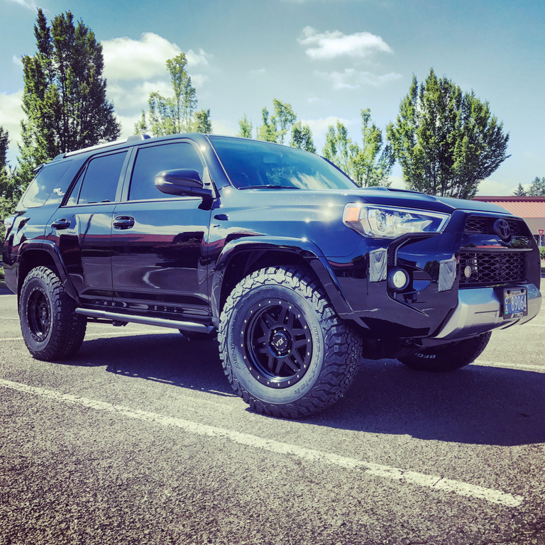

Looks really good. I had my KO2s on for a couple hours and had to get them dirty. Very important to test all new equipment.
I really want to get out there and get them dirty, but so does the girlfriend and I promised I would wait - Boyfriend of the year award?
It super sucks that we have friends coming in this weekend on a last minute trip and so we can't get out to the woods.
It will happen soon though.

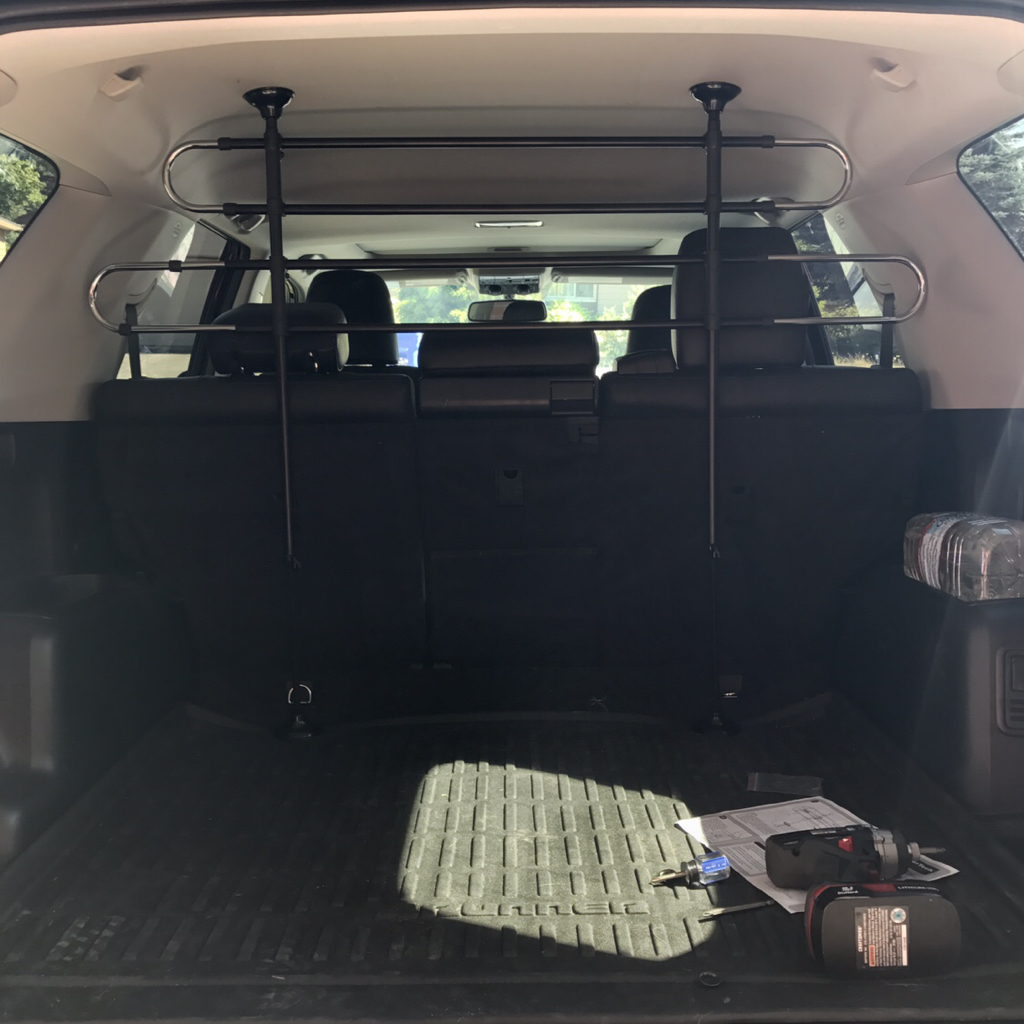

Installed the pet barrier as well. Don't think I'm going to keep this as I don't like how it presses on the floor and roof as it might cause dimples but it will be a good temporary barrier for the dogs tomorrow

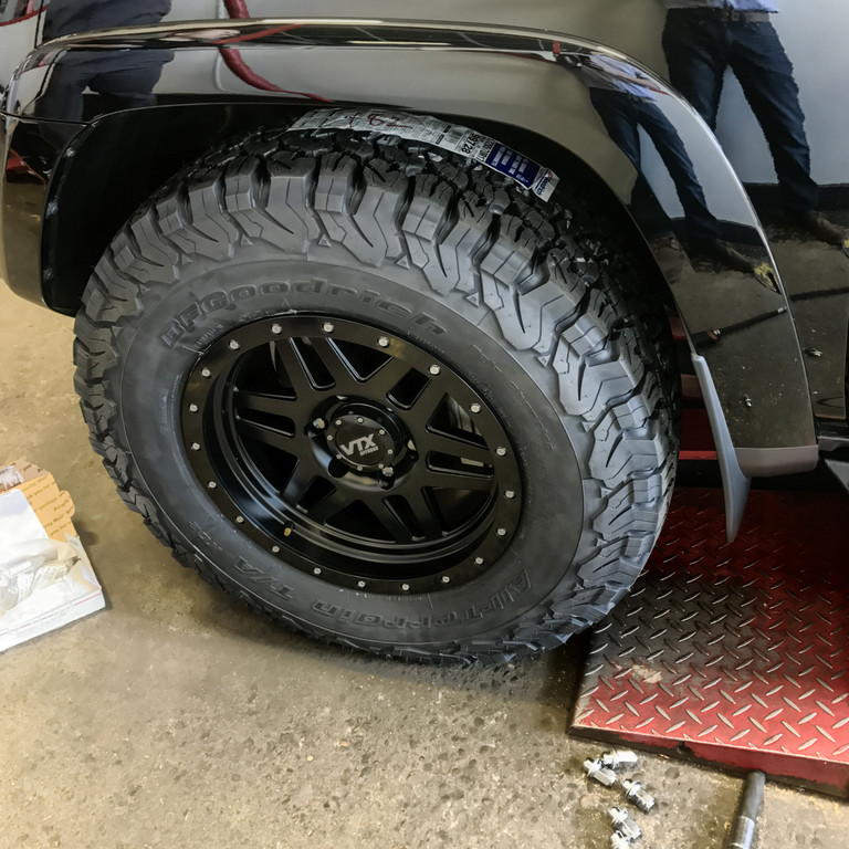

RustyTKO
Nice build! Been following for a bit.

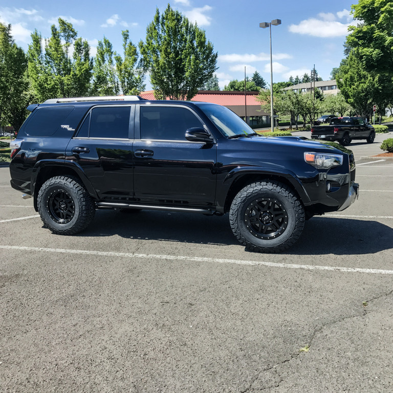

The KO2's in 285 are almost 33", did you do a lift or is it stock height? Do you have any rubbing or turning issues with that size tire?
A10MileHusker
1,798
West Slope, OR
3628

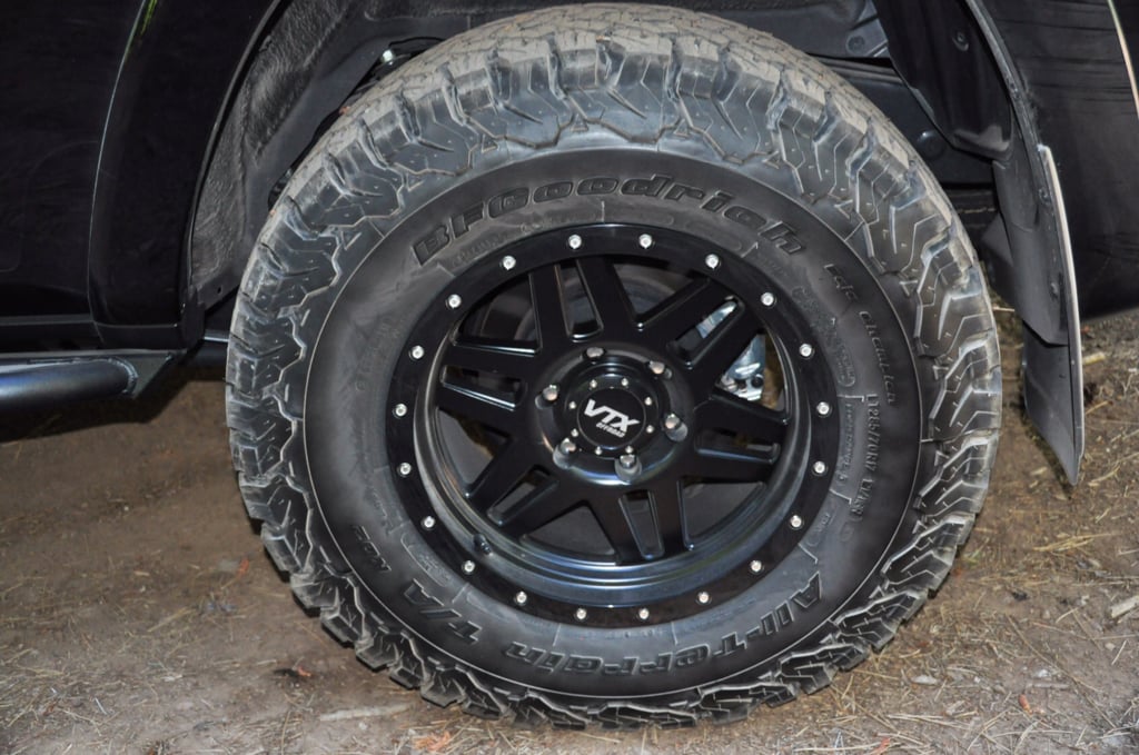

Thanks man! I have the rig completely stock suspension wise. It definitely rubbed. I did the fender mod and that helped a lot but I still rub at full lock against the Body Mount. I am about to do the body mount chop (hopefully this weekend) if I have time after installing my CB.
That being said, there are many people who also have the 285 KO2s with zero rubbing. A lot of that comes from the fact that I have an 8.5" wide with -10 offset wheel. Most people kept the stock wheels with the KO2s and dont rub.
