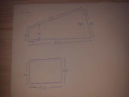

For the colder seasons, I've been wanting insulation for the poptop roof for a while. The roof itself is of course insulated. Now something to come for the tent fabric. Something made of probably a fleece fabric, which I will attach if necessary inside with tent. Fleece does not weigh much and insulates well and takes and gives a certain amount of moisture. On the tent fabric, however, I have some Velcro (hook side), for example, to attach mosquito nets. Since I still have to think about a solution that the fleece fabric is not damaged too quickly because it attaches to the velcro hooks.
This is what it looks like from the inside in the roof:
First measured everything, every good project starts with a sketch - haha:

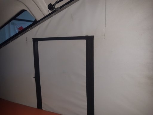

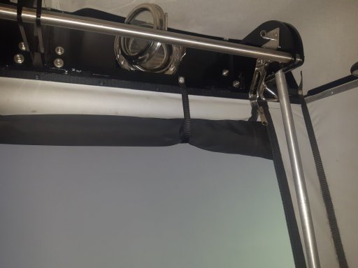

This little project also finally continued today. After a delicious and extensive breakfast with fellow overlanders I have set up at the sewing machine when I was back home.
First of all, everything is measured again. Cut the different fabrics. I use three layers: a breathable and waterproof fabric for the outside to the tent canvas, in the middle a layer of thinsulate insulation and inside a quilted lining so that it is cozy.
First, I sewed the velcro straps to the first layer for later attachment to the pop top roof's canvas. Then sewed the three layers together. And at the end I sewed a webbing around the edges for the optics.
A few photos:
I am very pleased with the result, so next I will sew the insulation for the side walls. For this, however, I must first get new material.
