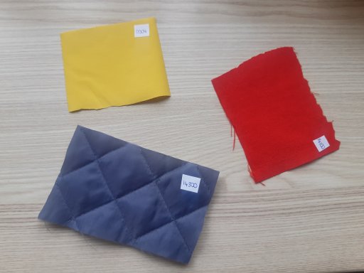

Today the fabric samples arrived. I will now subject them to a little stress test, e.g. whether they withstand Velcro. I think I will probably choose a combination of a quilted fabric which is comfortable for the inside and a waterproof / breathable material for the outside. In between a layer of Thinsulate for insulation.

So, have tried around with the fabrics. And measured everything again. You know: measure once, cut twice or something like that - hehe. It will be a combination of quilted lining, Thinsulate and a breathable fabric. Everything ordered for the rear part of the tent to try out how it works. Now we are going out for three days to follow the call of nature, camping and paddling and then I will continue with this little project. Stay tuned.

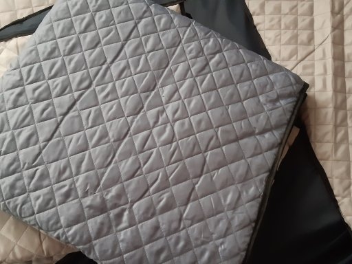

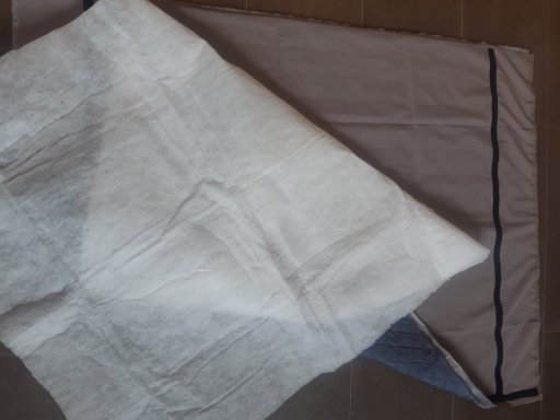

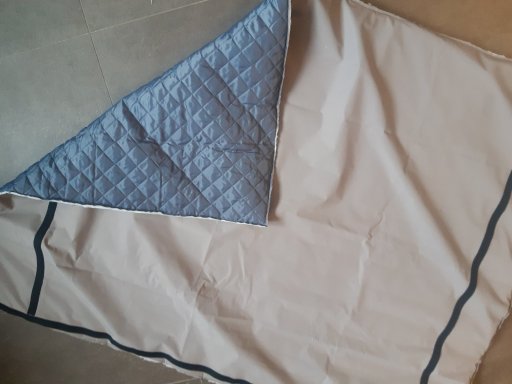

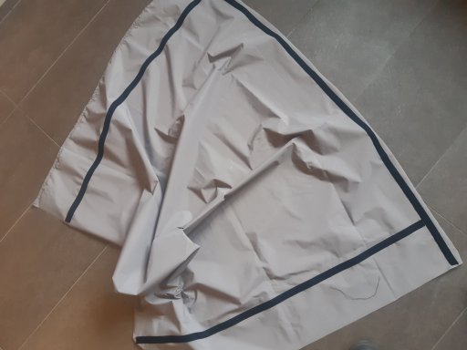

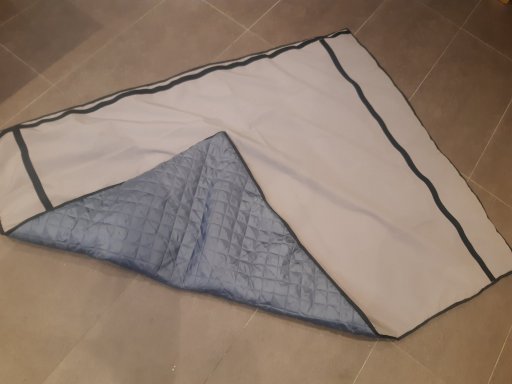

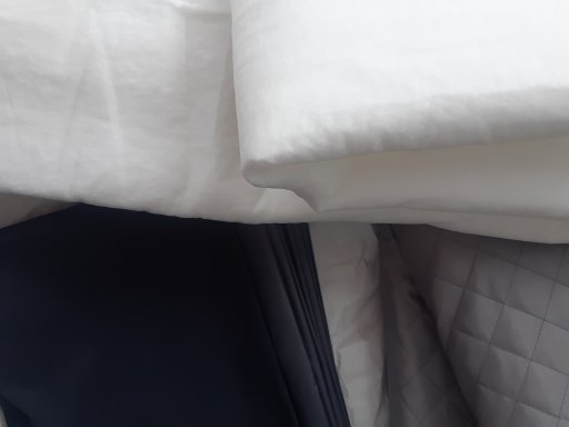

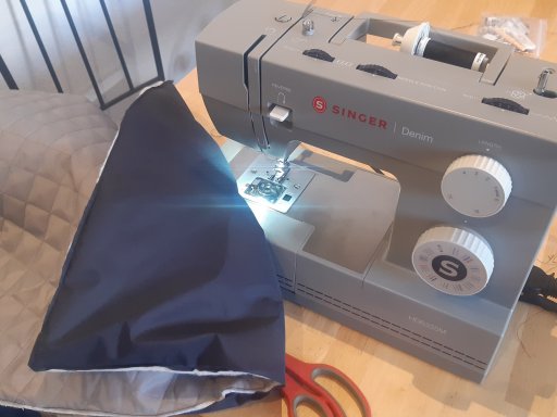

This little project also finally continued today. After a delicious and extensive breakfast with fellow overlanders I have set up at the sewing machine when I was back home.
First of all, everything is measured again. Cut the different fabrics. I use three layers: a breathable and waterproof fabric for the outside to the tent canvas, in the middle a layer of thinsulate insulation and inside a quilted lining so that it is cozy.
First, I sewed the velcro straps to the first layer for later attachment to the pop top roof's canvas. Then sewed the three layers together. And at the end I sewed a webbing around the edges for the optics.
A few photos:
I am very pleased with the result, so next I will sew the insulation for the side walls. For this, however, I must first get new material.

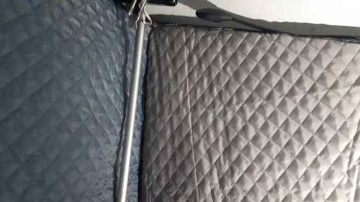

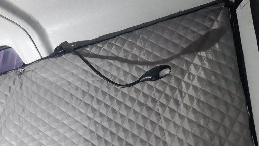

New material has arrived and I was finally able to continue with this. All three sides are finished. Buttons for fitting in the rig have also arrived. This week I'm going to do the assembly in the rig and then at the end of next week we are heading off to Norway and we will see how the new insulation performs.

Back home safe and sound from the winter Arctic trip. What an adventure. Experienced temperatures of down to minus 34 C (minus 29F), which was also a personal record for me. The DIY-insulation really makes a huge difference. Even if you don't heat the interior, much less heat is lost. It's also more comfortable and you're not right up against the (cold) canvas of the pop top roof. I am very satisfied and can only recommend doing the same with a setup like this. If anyone here would like to make something like this and needs help, please contact me and I will be happy to help you with fabric selection, fittings, dimensions etc.
