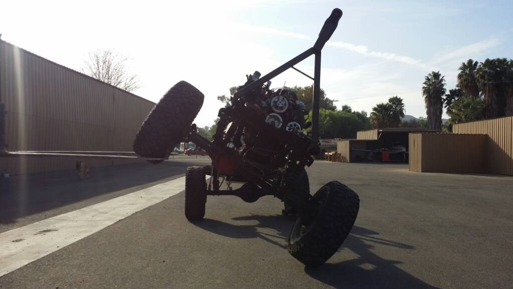

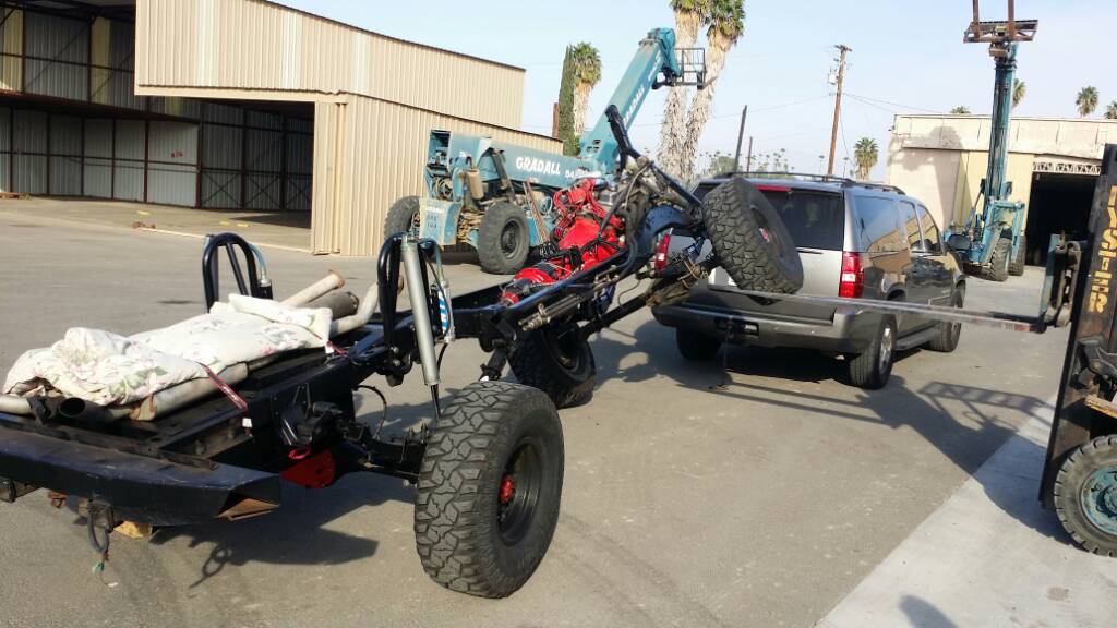

Seeing the frame twist like that gives me the willies....
Yeah man, looking back I wish I wouldn't have lifted it so high. I'm really lucky that it didn't do any damage... live and learn I guess. [emoji53]

Wonder if you could box in the frame, assuming you already haven’t? Maybe some more crossmembers? I have a feeling with the weight of the body and contents that you would be ok, but just from a rigidity standpoint, boxed in frames are stronger

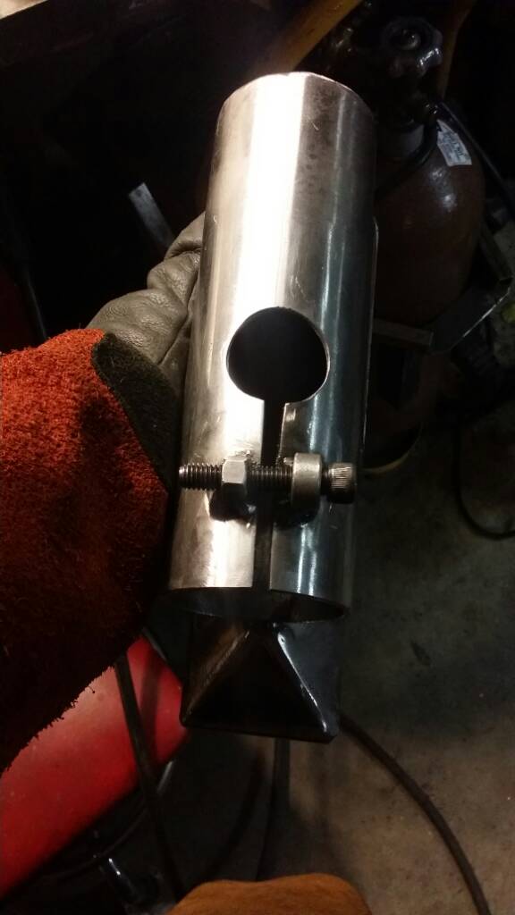

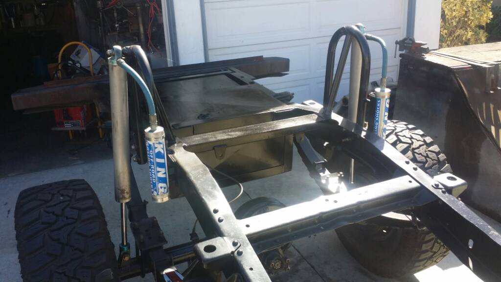

Bumpstops figured out. It looks like my shock body might hit the bumpstop can at full droop, I sure hope not. I won't know for sure until I cut, curve and lengthen my shackles so I can actually achieve full droop. But I like the results so far... just 3 more to build!
I had to build a contact point onto my u-bold plate to get everything to work.

If you are really that curious to see if its going to touch make a spacer the same thickness as your leaf pack minus the main leaf, then disassemble the pack leaving only the main leaf and your spacer installed. Cycle your suspension and check for clearances, make sure you've got a solid 3/8" of space between everything as that will ensure that if you're really given'er on the trail everything should still maintain a safe clearance.
You're right about that... unfortunately that won't make any difference with my stock shackles as they hit the bracelets and won't allow full droop, hence "cut, curve and lengthen". Its all good at full compression.
