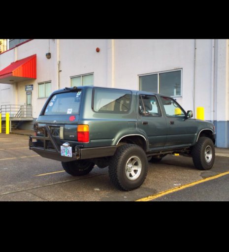

On mine I just did a 2” body lift and it fit the 33x10.50s with no issues . I mainly did a body lift because I wanted to keep the smooth factory ride and I moved the drivetrain up 2” so I could build a belly pan skid plate for it .

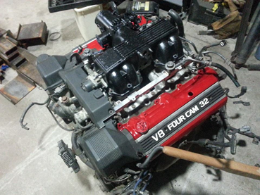

this is my 3rd 2nd gen 4runner, i just have always loved them even with the flaws. This time with my 3rd 2nd gen 4runner i have done something different and unique and have done all the work myself, i have taken out the 3.slow and swapped in a 1uzfe from the lexus ls400. on top of that i mated the r150f manual transmission behind it and lifted the 4runner a total of 8" (considering on dropping down some) and added much stiffer swaybars to help with body roll. still a work in progress but i love it.
dont have a pic of motor in the truck but here is the motor that i put in
