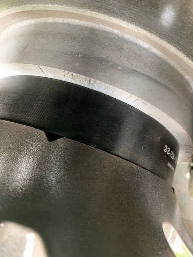

Yes I got them put on. They are 295/70/18 so yup 34.3". I have the Trail Boss so it comes with a Factory 2" Level Lift on Top of the Z71 Suspension. I did have to throw some 1.25" spacers on all four to clear any rubbing issues but they look and perform great! No rubbing and min poke out (I think it has a better look like that anyways)

ohhh, ok, i see what you did. When you said spacers, your talking Wheel spacers that push out the factory wheels 1.25".
I suppose the factory BS (back space) on your truck is 24mm or (5.5"), at least on my '17 these are the measurements.
So, 18" wheels, with a stock BS of 24mm (5.5"), with a guess of a width of 8.5" width (stock wheels), and then add the 1.25" wheel spacers (31.75mm), would put your current BS at (24mm - 31.75mm = -7.75mm OR roughly 4.4" BS).
So, with a -7mm offset, no rubbing on the fender near the foot-well?
I'm currently running Method Race Wheels MR310 CON6 17x8.5 with 0mm BS (4.75"), with 33" tires.

I also have a small level of 2.25", which has worked very well with my setup.
Here is a little chart I put together to help understand back spacing and offset with wheels and their different wheel widths:
Your pretty much right on the button. I believe my Stock Wheels are 18x8.5 and BS is +34 though. The new Brake calipers on the re-design have a small bump out for reasons I do not know so they had to put a more positive BS on the stock wheels.
