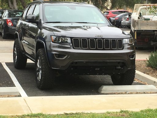

First wave of upgrades are as follows.
1. Dobinson ~2.5 inch lift kit
https://www.dobinsonsprings.com/4x4-suspension/jeep/jeep-62/jeep-62-catalogue-page?task=document.viewdoc&id=217
2. I sourced a set of 4 older 2015 WK2 18" wheels and had them powder coated. Paid a total $100 for them and another $240 to have them all powder coated.
3. Threw on a set of 33" KO2's.

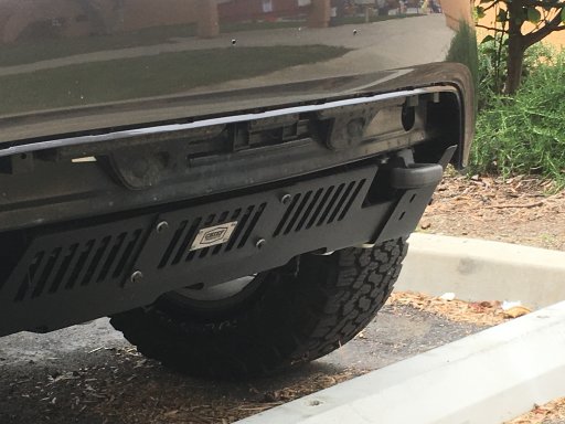

4. Two skid plate setups from Chief Products.
Front lower guard plates
http://usa.chiefproducts.com.au/products/wk2-lower-front-guard
Sump protection plate with an access panel for oil changes on the Hemi.
http://usa.chiefproducts.com.au/products/wk2-sump-protection-plate
I'll be posting update pictures of the actual vic (with better lighting) within the week. The Jeeps in the shop after I had a little too much fun in the desert during a shooting trip.

Agreed, they have this industrial raw look when mounted and are seemingly as thick as uparmored humvee plating. So far all of my mods minus the wheels/tires are from Australia. Few American companies are supporting the newer WK2's

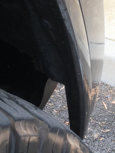

The dobinsons lift is great but it makes a few popping noises when the springs release tension. The lift shop told me they were the toughest springs they have ever compressed... ever. So let them know. They perform fine if you ignore the popping. You'll want the 1.75" spacers as well. If you're running a 33" tire on 18's the lift kit + spacers will cause your Jeep to rub on the inner front fender. I took some tin snips to the area and gave the wheel some more clearance.
You'll need:
Tin snips
Hand file
multiple grits of sandpaper
A marker
This will save you a lot of money vs taking it into a shop and it's super fun and easy to do. My wife cut one while I cut the other. I'll give you pics soon. (hopefully)
Your Jeep will look one of a kind and perform admirably. I squash my buddies TRDPro regularly. Not to mention it looks great.

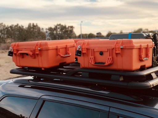

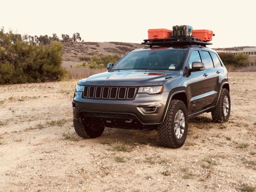

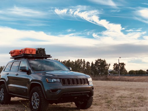

1. Rhino Rack Pioneer Platform installed. Took some modifications to make it fit. (Rhino Rack has some terrible customer service)
2. Also mounted are three orange Pelican 1560's on a makeshift quick release mounting system I fabricated by modifying three trolling motor QD mounts.
3. Two Wavian jerry cans are also mounted.
4. etrailer hitch mounted. The dealership wanted $750 to install the OEM mount and flash the software. That's not happening.
