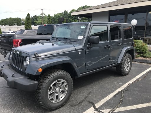

IMG_7868.JPG So I'm pretty far along into this build but decided to finally make a build thread to show the progress. I purchased this '16 JKUR in the color Rhino last month and immediately got to work ordering parts. This is my second rubicon and I pretty much knew where I wanted to go with this build from day 1. I was looking for as base of a rubicon as I could find and my only real necessity was a manual trans. So I found a leftover new 2016 with only the connectivity package and hard top. Perfect. Here's the rig after the test drive and waiting to be driven home.
