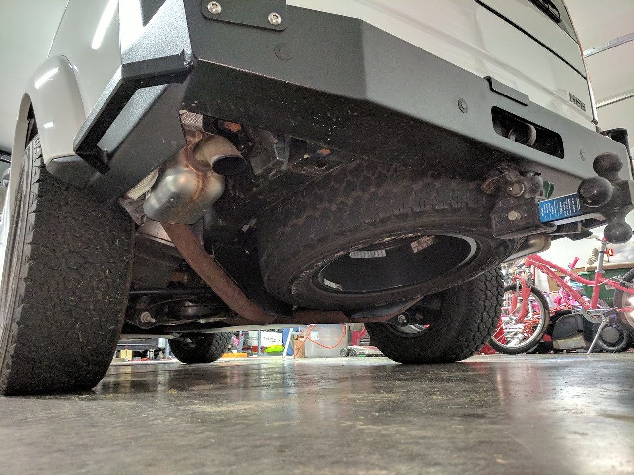

What are your thoughts on the 260/65/r18 size?
I'm not really interested in keeping the spare deflated.
I've heard of folks running that with no problem, but the spare would still need to be deflated a bit from what I hear.

I believe 265 60R18 is the largest tire that will fit in the spare wheel area.
Correct. But it has to be deflated to fit. Which beats the point of a full size spare for me.
I'm interested in the largest tire that will fit into the spare wheel area.

My understanding is you need to drop aprox 5# PSI or so. I will be trying it out this weekend and follow up.

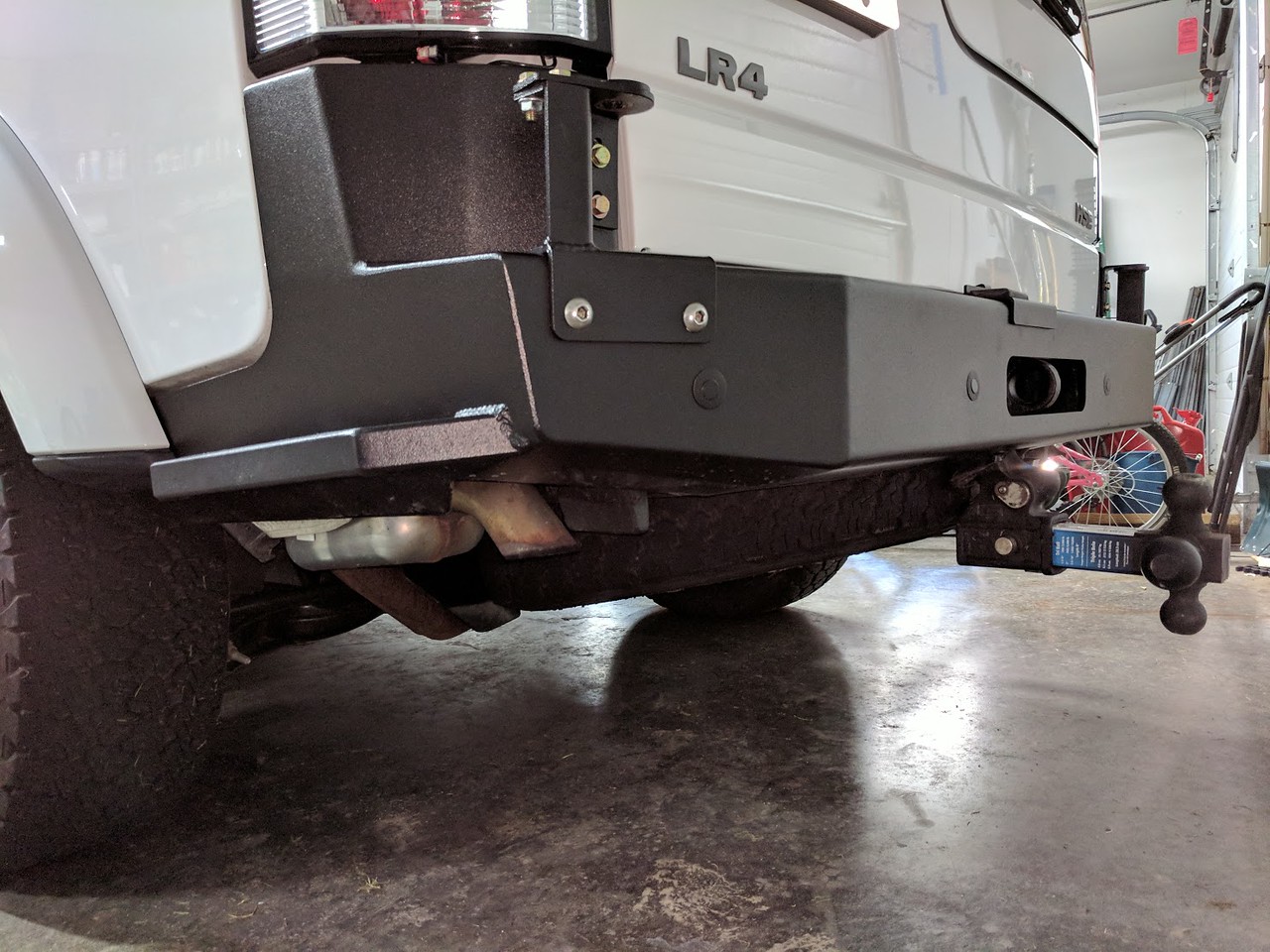

I keep a slightly warn, fully inflated, Goodyear 265/65R18 tire in my spare location when I am not using my swing outs, with the heat shield still there.. and it works fine. Its only slightly snug, a little kick and it comes out just fine. 265/60 is a good size though. You won't rub the frame horns or need the wire harness relocation if you go with that size.
I'll take all the tire lift I can get though, so I am sticking with 265/65.
It sticks down a lot in my case because of the Tactical Rovers bumper which gives more clearance. Even the exhaust sticks down a tiny bit. (but moves up when you hit things)

What an amazing build! Thank you for the thorough details - I'm looking to do the same to my 2015 and it's super helpful.
Did you run into issues with the rear bumper and the blind spot monitoring sensors? Have you got a dual battery setup? I'm finding it challenging with the 2014+ start/stop system.

The rear bumper parking sensors do work just fine (without the swing arms on) if you get them in there right. They can be a little finicky to get in right.
For my 2013, i just had to relocate the transfer case computer onto the alarm horn bracket under the brake lines in that aux battery box.

Chris your rig is gorgeous! Anyone have any issue with the parking sensors after arb bumper install? When I go in reverse, there is a continuous beep
