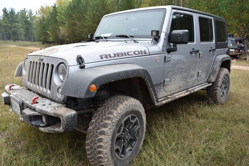

2015 Rubicon Hard Rock Build Mjolnir
toxicity_27
US MidWest Region Member Rep
3,278
Minnesota
0656
Well after the trip we took last weekend I definitely learned a few things but so far everything I've done to the Jeep performed flawlessly. The JKE-Dock performed well. The tablet with Backcountry Navigator did well also. However the tablet is just a little small for the RAM mount and rattled the whole time so now I'm looking I to option so to fix that.

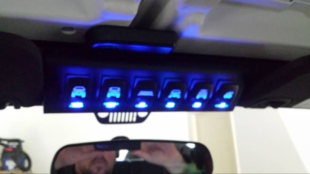

Installed a ComeUp Seal Gen2 9.5rsi winch, and was working on installing an ARB air compressor but realized when I got to the electrical that I needed another harness to hook it up to the sPod.
First State Overland
2,592
Delaware
504
Depending on how you want to set up your compressor, you don't need the extra harness for the sPOD. I went tank less and put an adjustable pressure valve on then that eliminated the extra harness and wiring. I have the pressure valve set to about 70 psi normally and I turn it on and let it run. The pressure valve blows off extra pressure to avoid damaging the compressor and nothing else is needed but a positive and negative from the sPOD. Of course this is different if you're going for a tank as it needs to have a shutoff. Just thought I'd mention it.
toxicity_27
3,278
Minnesota
0656
Good to know. I'm horrible with wiring, hence the reason I got the sPOD. I'll most likely buy the harness since it's not too expensive and will hopefully save me a headache.

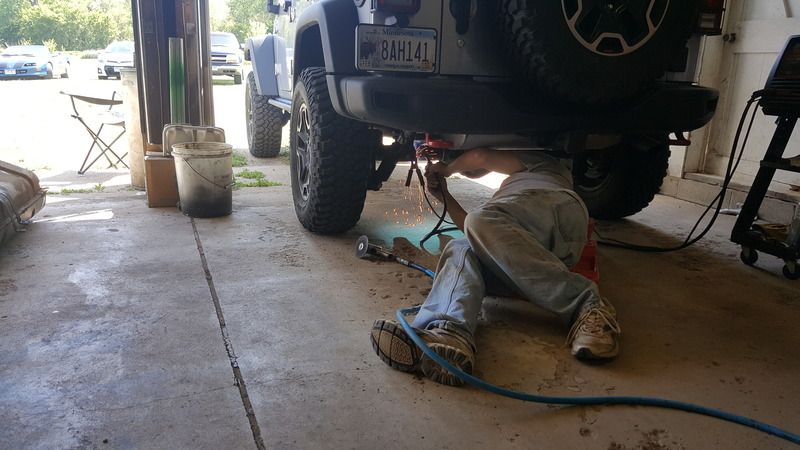

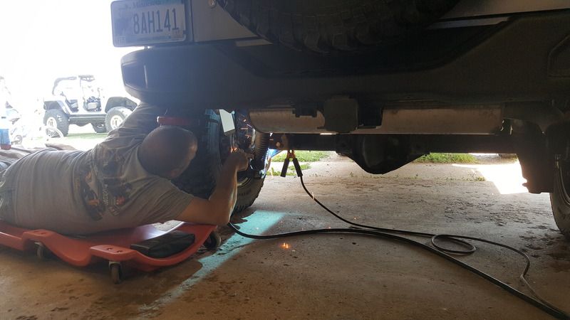

Hung out with some Jeep buddies today. We installed a new gastank and skid in an XJ (no pictures) and did some welding on my JK.
Sorry if the pictures look a little wonky. I'm working on getting out of auto mode on my DSLR and playing around in manual mode. Also some of them are from my phone.
