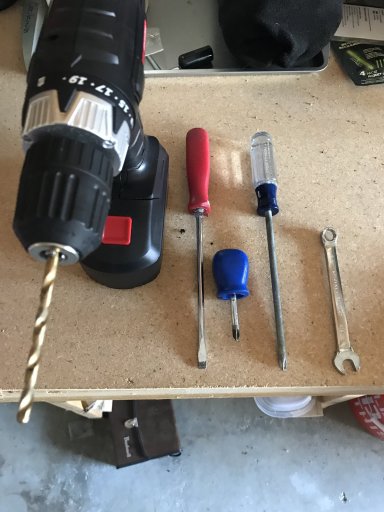

also, these were the ONLY tools needed to accomplish this project.
1x drill bit accommodating the screws you intend to use
1x electric drill
2x philips screwdriver (i used two. one long for the cubby screw and the short for the back screws near the interior side of the window)
1x flathead screwdriver (to pop the snaps for the speaker screen on the cubby)
1x wrench to tighten down the nuts i used for my screws
1x harbor freight variety pack of screws and nuts i use for ALL my projects that do not include mounting hardware
