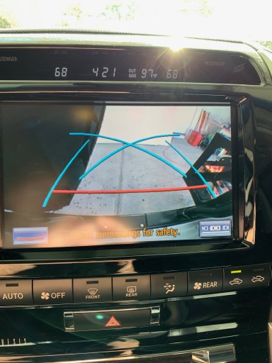

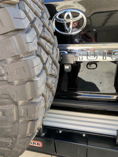

Procrastination is a killer, but I finally got around to installing the rear camera relocation kit. Went pretty smoothing and is pretty straightforward. There were a couple things to note though:
  • I messed up a little bit forgetting a secondary heat shrink on one of the wire connections
  • the wire included in the kit is a larger gauge than North American LC camera wire; there are also 4 wires going to the camera, the kit only includes two wires
  • I'm a little concerned about how it'll fair in wet weather because the camera is moved to a more exposed position
  • the old (original) camera mount is an open hole now. Not a massive hole because I covered the wire with wire loom & tessa tape, then fed it through the original camera mount. A little disappointing there isn't any covers included in the kit though (someone with a 3D printer could likely whip something up)
This is the before. The hole on the left is the original mounting position. The hole on the right is where the latch release/lock/unlock buttons are. The new mount is stacked onto the latch release mounting point.
The camera is a lot more exposed in the new position and the metal shroud over top doesn't provide 100% coverage to the back of the camera or the wires/connection. It has decent coverage though and should prevent most moisture/snow from piling on top of exposed wires.
I can see again! Mostly unobstructed view out the back now. Way better than the original position even though the spare is still blocking a third of the screen. Guidelines are still pretty accurate too (from limited testing in my garage).

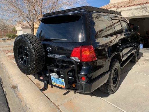

Took the weekend to install the front suspension parts and it was a doozy. Definitely made it harder on myself by not using the right tools for the job. Managed to get the job done 98% in two days. Then I got massively stuck connecting the final stabilizer bar link. Finally broke down and posted on IH8MUD for some advice. Ended up putting a long socket on the bolt and just muscling it into place. But I got it done in time for my appointment to get the new wheels mounted and aligned.
Also, turns out the misaligned steering wheel wasn’t because of the KDSS it was really due to how bad my alignment was.
Thursday morning I went to 4WheelParts and got the new tires and wheels installed. They told me an hour but had a lot of trouble for some reason. I was there for 5 hours. But she’s looking good now.

Let us see that rear ARB bumper in all it's glory:blush: By the camera install pic(closed), i see you mounted it on the left, but the interior hatch shot makes it look like it's on the right?. Looks like a 'dual' Jerry-Can holder on it?
