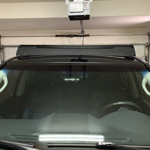

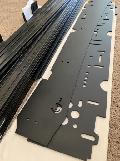

Ordered and received a few items from my list in the first post as well. Unfortunately they’ve been sitting around a little while because I keep procrastinating.
Prinsu roof rack with a couple load panels
Replacement LEDs for the interior and some leather/vinyl protection

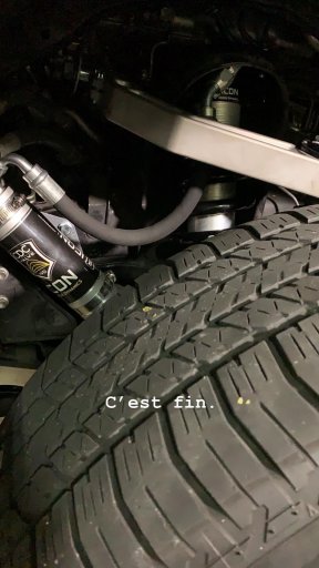

Oh mama. Getting into the big time now. Last weekend I decided my procrastination had to stop. It was time to start the suspension.
Thanks to a couple kind souls at ih8mud I got a peek at the FSM for my truck and was able to get to work. Icon has fair enough installation instructions but it’s only for install (and very plain, vague language at that).
Hit several bumps along the road:
* nut holding the top of the shock absorber was on wicked tight
* my brain kept thinking I had to turn the shock one way and the nut another, but it was the wrong direction (did the same thing on the second shock even after figuring it out on the first one)
* holy damn 110ft. lbs of torque is tough to get to when laying on your back under a truck
* I wasn’t sure I’d get out of my garage after the install was finished
* holy damn the KDSS set screws are locked in tight!
* make sure you wheels are straight when resetting the KDSS (I now have a slightly crooked steering wheel because mine weren’t)
But over all I’m frickin stoked! I did this. I swore a bunch but I did this thing.
That rake is hilarious.
Front suspension is going on this weekend, so I can hopefully fix the KDSS issue and what seems like an inch difference in ride height between the driver and passenger side (driver is lower even though I added the icon spacer to the spring on the driver side).

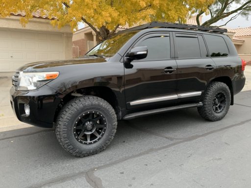

Took the weekend to install the front suspension parts and it was a doozy. Definitely made it harder on myself by not using the right tools for the job. Managed to get the job done 98% in two days. Then I got massively stuck connecting the final stabilizer bar link. Finally broke down and posted on IH8MUD for some advice. Ended up putting a long socket on the bolt and just muscling it into place. But I got it done in time for my appointment to get the new wheels mounted and aligned.
Also, turns out the misaligned steering wheel wasn’t because of the KDSS it was really due to how bad my alignment was.
Thursday morning I went to 4WheelParts and got the new tires and wheels installed. They told me an hour but had a lot of trouble for some reason. I was there for 5 hours. But she’s looking good now.

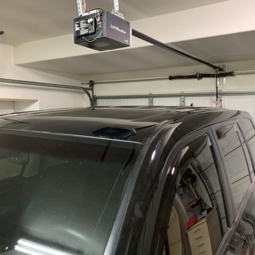

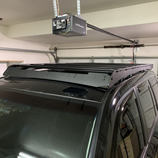

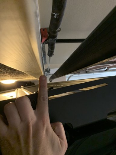

With new tires and lift does it fit in your garage still?
It does! But barely
Definitely can’t go much higher with the lift or roof rack, that’s for sure. If there’s anything thicker than a ½-inch on the rack it won’t fit in the garage.
