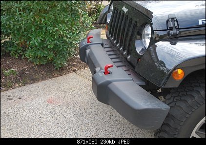

This past weekend It rained the whole time so I went ahead and built and installed limb risers. I took ideas from a lot of people's designs and I'm very satisfied with the outcome. (sorry for the terrible quality photo, camera was dead so I took it with my iphone) limb-risers_26507032520_o.jpg

I've been thinking about making my own limb risers. What did you use to connect it to the hood latch? I know most designs have a plate that goes behind.

I used this. Check out this item on Amazon: Simpson Strong-Tie 4x4 Deck Post Tie
Simpson Strong-Tie
I used a dremel to cut the two side pieces off as evenly as possible. Then I took off the hood latch and used a sharpie to mark where the holes should be and drilled through. I used plasti dip and coated the two brackets so it would be black on black. I meant to take step by step photos but got caught up in the work.
Just a note though, I still have the stock hood latches on and with the limb risers on tight it pulls the latches and exposes the weather strip under the front of the hood. I'll probably replace the hood latches pretty soon.

Thanks for the info.
