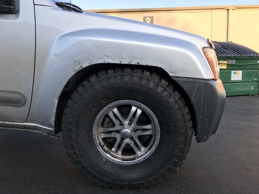

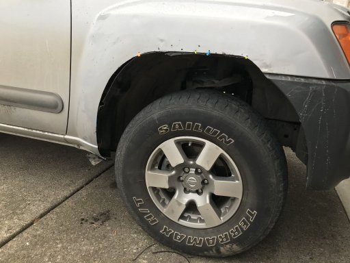

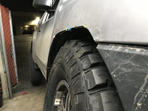

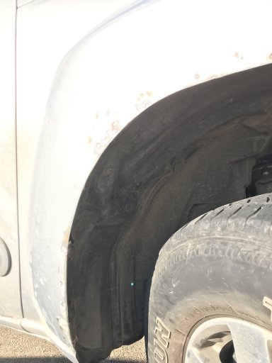

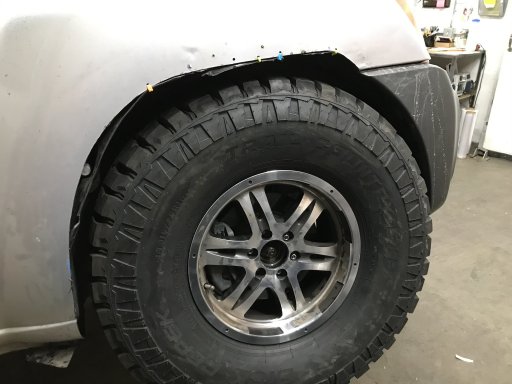

Got the rest of the liner stretched out and tabs welded in to hold it . My welder half took a crap because the nut that holds the positive terminal on must have loosened up at some point and melted the stud halfway so my welds turned out like crap and I will have to redo some of it later but now it’s time to drink to much and stuff my face with turkey . HAPPY THANKSGIVING EVERYBODY!!!5ADE85E4-8F9E-4F86-BBAD-DD520585BD46.jpegB132D7E4-289A-405B-B9E3-03BDE3976C9B.jpeg

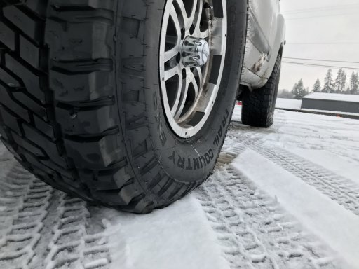

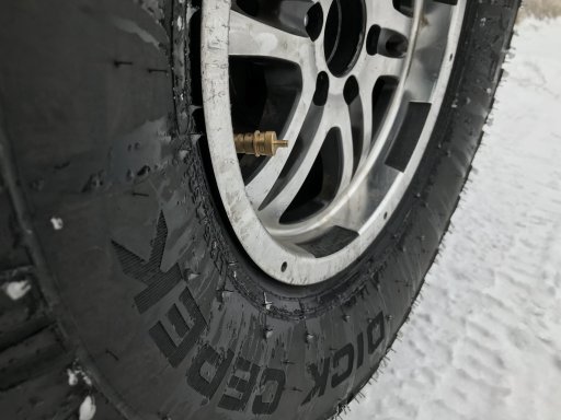

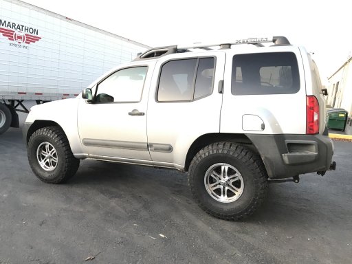

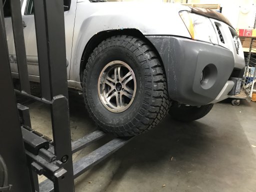

Initial impressions of the dick Cepek trail country EXP 315/75r16
For being a aggressive AT these things are quiet , small amount of road noise but no annoying droning or MT type whomp whomp whomp noise .
Turning seems no different and with the light tire and wheel combo acceleration seems almost the same , I can still accelerate from 55 in 6th with no issues and driving up the hill to my house is still effortless in 3rd .

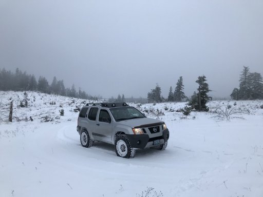

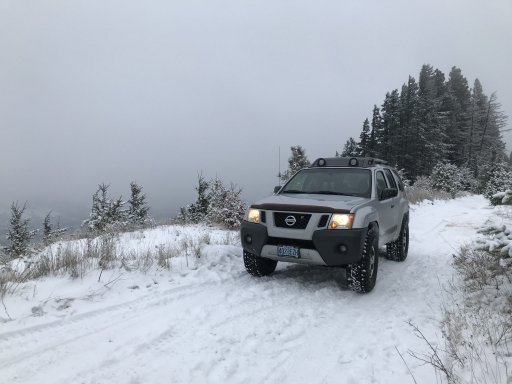

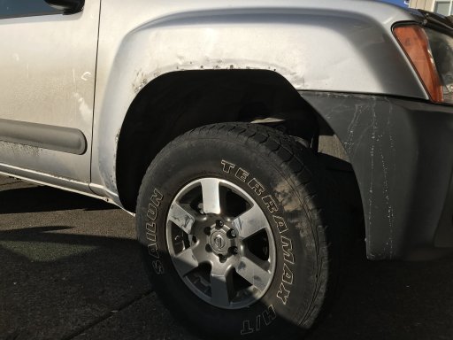

Still need to do more trimming and some spacers for the rear wheels but couldn’t resist a little snow fun after doing a wine club pickup with the fiancé . Tires did well but I didn’t air down enough at first , 16 wasn’t quite enough but they seem to like 12 psi . Got a little hung up in a 4 foot snow drift but thankfully a guy came by in a SAS yoda and broke trail for a couple miles . All in all a good day . 2171B75F-E37C-4DA1-8CA2-0A3006EE4069.jpeg28143CE0-D8DF-4C35-B5FC-DFF3EC6A0A73.jpeg08D3E96C-86D2-4604-9AC6-2929D401135E.jpeg446C75B4-29A8-4943-9947-1E3A91C895FA.jpegD4630117-D74A-4322-A1A9-EEFADE2327CA.jpegCBFF4908-5B25-4427-AAD0-230945682537.jpeg78BA13A5-036C-43FC-A460-5E1F5C0F9A0D.jpegE9857C04-CDFE-44B1-8741-BA344127C0E2.jpeg

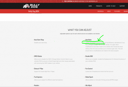

To piggy back on Terry a bit. It may be benefit to take a gander at a Bully Dog Pro to let you adjust the speedo and shift points for different size tires. Among many other things.
I've never heard that the bully dog will correct the speedo on a 2nd Gen.

EDIT: Will move Bully Dog discussion to a different thread.
Digging your rig set up. Great job on the fenders. I like the way it's turning out.
It does. I have not verified accuracy, but it does change it on 2nd gens. Considering my rig has 4.11 gears and 35's the BDP is darn near a must just to get the shift points where they need to be.
