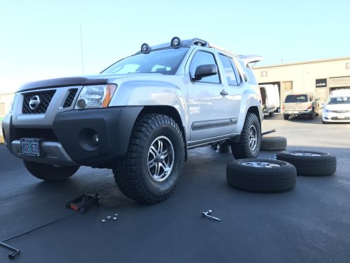

It’s in , fairly easy install took about 2 hours. Take some pics later when I get it on flat ground , my driveway is angled so it looks super crooked

Ooh, quick thought. Did you get the bump stop spacers for the rear? Those OEM Xterra springs DO NOT like being inverted (well most springs don't but the especially) like they will with a shackle lift. They'll break down pretty quickly.
I have the Timbren bumps in mine and love them.
No I didn’t , think the springs are already shot from I’m guessing the PO towing with it . I think I’m going to replace the springs eventually with a set of Chevy 63 inch leafs.
But for now it looks much better and way way better not bouncing off the bump stops and Having a little more travel out of the longer shackle. 38C7D948-6330-46CD-954F-DB5B227FBA84.jpeg8958319A-6161-4348-AE9F-8EAABEA0EE4E.jpeg

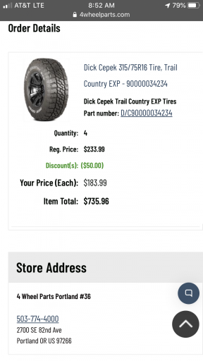

Tires are on the way , was going to just stick with 285s but I couldn’t pass up 315s at this price , unfortunately they won’t be here till Tuesday 15DFB259-6541-4397-BB88-280BD8E90CA4.png

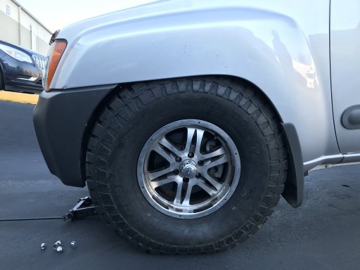

Got 3 of my tires today ( 4th one coming out of Cali) scored when I stopped by a tire shop to have 1 mounted on my spare wheel to test fit things and the guy happened to have a set of 16x8 with a +25 offset wheels for 200$ .... score !!
Initial impressions
With the right offset and the tire being a little skinnier than most 315s things are lining up fairly well in the front they clear all the suspension and frame under steering lock , I will need to take about 2” out of the wheel well to clear and some melting of the fender liner but so far it all looks good .
In the rear I will need to remove some of the bumper , notch the frame at a angle |_\ and replate it and maybe need a 1/4” wheel spacer and some longer bumpstops .
great thing is the tire and wheel combo comes in at 85lbs .
so I do have some work ahead of me but so far everything seems to be lining up where I thought it would be .E920EE43-BD96-44E2-8CCD-3003169E187C.jpeg7EDEB388-4013-4490-9F8A-972CCEF9A1F4.jpegCA22B64D-E709-4CC7-9406-FEAF1DE014D8.jpegA6E20726-7FEE-43B2-8FC9-2F0F7A8991A2.jpegC39657B0-4E29-41CB-8AF1-09A382DB02B6.jpeg3C17DDAA-09AB-4748-89EE-AAD413FB7C0E.jpeg5606D453-6E63-44ED-BA56-986951A53430.jpeg5F4C9BD3-B57B-4DAE-91D5-74411A52A288.jpeg
I guess I should Take some pictures of the actual tire LOL. Tread should work great for my needs general trail riding and deep snow. The extra size when air down will really help to smooth out the ride and leave me a nice wide footprint to grab fresh powder. 061587B1-2642-4B7F-B01A-45F52D1AB183.jpeg1816DDDD-072E-4425-8B10-8CAAA677979B.jpeg27B55747-D1B9-4C1F-9C65-4B90A198C1F0.jpeg
