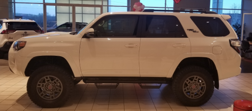

I ordered some grey OEM TRD Pro wheels that I'll mount the BFG KO2's onto, add a leveling kit of some type, add some Nerf bars (that my buddy's selling me for half … he just traded his 4Runner for a new Tacoma), and it'll look just like this (without the dark tint):
