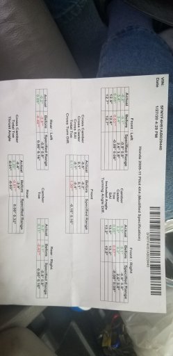

They're a good shop. I've been going there for 6 years (since I moved here) for tires. I was very friendly with the owner and knew his son. He sold out, but apparently to another stand-up type of guy. Apparently a friend of the original owner. They might have bitten off a little more than they could chew. When I asked if they could install the lift kit, the front desk guy was all like "Of course, no problem, we can do it" with no hesitation at all, so I was fine with it. The mechanic did screw up something for sure when he let it down off the lift the first time and tweaked the right axle driving it. They just wanted to make it right. So here's more background now that I have a minute...
I brought it in before noon on Saturday. They said it should all take 2 hours. Over 5 hours later, and an hour after closing time the axles were out of it and I was in the shop talking directly to the mechanic. He was pretty spun up and frustrated and I wasn't on my A game either, cuz now I would be without a vehicle for days. Plus their alignment machine crapped the bed, etc etc etc … I took Uber home. I was able to borrow a car from my Ex Wife, so I felt better. I was also working on two days in a row with very little sleep. So it a wasn't real fun meeting.
The mechanic and a helper came in on Sunday to try and make it right. I stopped by after hunting (I'm on a really nice buck, but that's another story) and nothing was going right, couldn't buy parts, was going to flat bed it to the next town over cuz their alignment machine was down, etc … So I told him that I have a car and to chill out and just go home and apologized for being a little grumpy myself the night before. So he really appreciated that.
They worked on it Monday and decided to replace the axles because of the vibration, I assume thinking that he messed up the bearings or something (because he mentioned that specifically to me) … that's where I have no way to really get the whole story … but something happened and decisions were made by the owner.
Tuesday they changed the axles and got it aligned and road-force balanced the tires. I got it up to 80 MPH last night and the tires are perfect.
