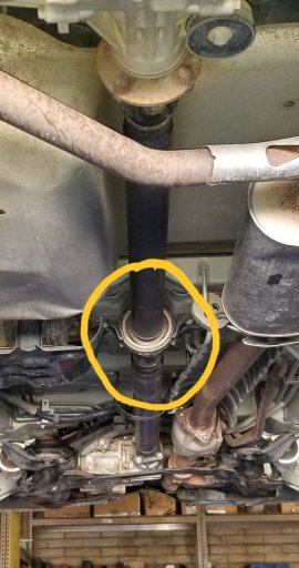

That steady bearing, the rear dif, front joint are all completely stock and none of those parts have moved from stock. It would be odd for that to be the problem. But I would definitely think the steeper angle for the half shafts could be the problem. Unless someone builds half shafts with joints capable of steeper angles I'd think the only solution is dropping the front and or rear dif. Something often done with other vehicles. Wranglers use a 2" motor mount lift to counter the steeper rear driveshaft angle after a lift.So here's what he pointed to as a possible culprit in the drive shaft. IDK if it's a support or a bearing or a U-joint type thing. I'll take a closer look at it later. View attachment 137914
I'm still trying to understand the reasoning to this. the differentials were NOT moved in the vehicle. the only thing changed was spacers placed on top of the struts. The only thing changed is the angles the CV axle needs to move between the differential housing and the hub at each wheel. I'm still wondering if you have added more height than the CV's can accommodate and you are getting a bind as they rotate. I assume the Pilot is a car based platform? I wonder how much wheel travel is built in from the factory. By adding the spacers, you take up 2" of that amount.Hi Aaron (I have that right, yes?),

You may be right abbout the axles, but they had this problem WITH the original axles. That's why they changed them out (to eliminate that possibility). I wish to hell I'd have thought to get them back a day before though! But that's water under the bridge now. Too bad the 4x4 shop couldn't have gotten it in today though. He seemed to think it was more likely drive train/shaft. The Honda service manager thought so too. He pointed towards the bearing(???) that's about halfway down the drive shaft. Ijust hope it's correctable for a reasonable amount of money. Putting $3k into a 10 year old car with 190k on it really wasn't part of my game plan.
Also, do the CV's pop in to the differential or bolt on to the side? with the added lift, is it possible the CV's are too short and are being "pulled" apart as the vehicle runs down the road? Since you brought the wheels down in relation to the differential, that distance between hub and differential is now increased. Even if it's only a little, it might be causing issue.That steady bearing, the rear dif, front joint are all completely stock and none of those parts have moved from stock. It would be odd for that to be the problem. But I would definitely think the steeper angle for the half shafts could be the problem. Unless someone builds half shafts with joints capable of steeper angles I'd think the only solution is dropping the front and or rear dif. Something often done with other vehicles. Wranglers use a 2" motor mount lift to counter the steeper rear driveshaft angle after a lift.
While your carrier bearing may or may not be worn, it was NOT modified in any manner during the lift. You need to NOT fall prey to "throwing parts" at the vehicle and concentrate on areas that WERE MODIFIED in the lifting process.So here's what he pointed to as a possible culprit in the drive shaft. IDK if it's a support or a bearing or a U-joint type thing. I'll take a closer look at it later. View attachment 137914
I agree that the steady bearing (thanks for the name) probably didn't move from its original position. The axle angle change is what makes sense to me.That steady bearing, the rear dif, front joint are all completely stock and none of those parts have moved from stock. It would be odd for that to be the problem. But I would definitely think the steeper angle for the half shafts could be the problem. Unless someone builds half shafts with joints capable of steeper angles I'd think the only solution is dropping the front and or rear dif. Something often done with other vehicles. Wranglers use a 2" motor mount lift to counter the steeper rear driveshaft angle after a lift.

If the steady bearing were the problem it should have been there before the lift too.

I had a lot of axle vibration :)I don't see anywhere in your vids and posts that you've experienced a vibration on acceleration problem like I'm having ... have you?
Shoot ... how did you correct it? Or did you? Do you just live with it and run OEM axles till they break?I had a lot of axle vibration :)

This only happened with 3rd party axles. Honda axles work great!Shoot ... how did you correct it? Or did you? Do you just live with it and run OEM axles till they break?
I understand that. I wish I could get my original ones back, but I can't. But just so I'm understanding you:This only happened with 3rd party axles. Honda axles work great!
