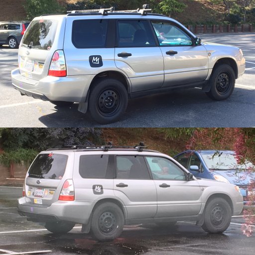

On one of my daily searches on Craigslist I came across a set of 215/70/16 Yokohama Geolander a/t-s, barely used, and well taken care of. I couldn't resist! Drove down to Santa Cruz with a buddy to pick them up and ended up meeting a fellow Overlander (not a member on here). Got them on the other night and it is a tight fit! Rear there is no rubbing what so ever, on the front it is just on the inner wheel well plastic lining. On the drivers side I decided to cut back the liner to stop the rubbing only to find a nice metal joint sitting millimeters from my tire. Daily driving should be fine, but I will definitely be doing some slight modifying before heading offroad anywhere. Overall I thing they fit the Ubaru much better than the factory 215/60/16. Enjoy the pics below!
Any of you other Subaru rigs run the factory steelies? Is there any need for a dust cap?

Looks like you've got a date with an angle grinder and some undercoating. Or a BFH. All depends on how much of an issue there is. Gotta love rubbing issues...
I don't run steelies but there's no need for the cap. You may want to smear a super thin layer of grease or anti-sieze to the wheel/rotor interface to prevent them from attempting to become one with each other. I'd give the hub a nice shot of black paint so they match before you do though.

I run wrx takeoffs for winters, but you would have to watch your offset closely with those tires.
Forester et is 48, Impreza, wrx, and outback are usually 55 so you are closer to the rear struts.

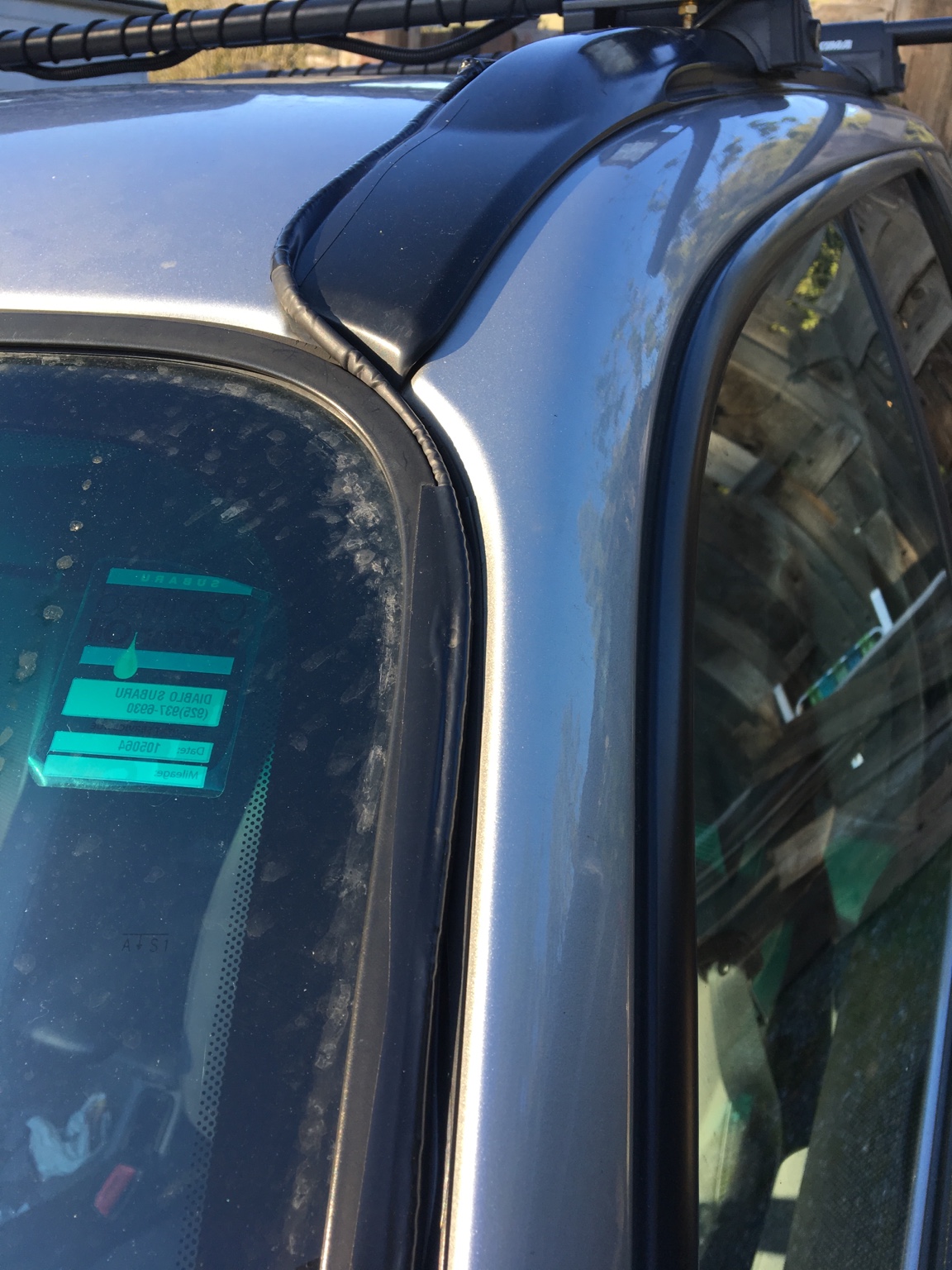

krzyboy2o - I got some shrink tube and ran the wires through that, then ran the shrink tube down the windshield weatherstripping and under the hood. Then down the windshield I covered the shrink tube with electrical tape to hold it in place. Up further on the roof I also ran it through some wire loom for an extra layer of protection. Overall Im happy with it. You really dont notice it with the tape down the windshield, and I didnt have to cut a hole anywhere. Heres a couple pics before I taped it. Ill try and get some more once it stops raining here! IMG_5365.JPG IMG_5364.JPG

That's pretty clean! I have to
check is the SJ has "lip" between the windshield and the pillar.

That's a lot cleaner than the "temporary" Mickey Mouse job that I did on my Outback, and left that way until I sold it. And then turned around and did it the same way on my 4Runner until I get around to doing a major electrical modification...

Here are some pics with the electric tape covering the shrink tube. It's held up just fine through a couple good storms so far!

Welcome fellow Forester owner! I love how fast this Subaru off road community is growing. It's awesome! I like your idea for running the wiring for your pods. I went back down through the rear hatch, but this is great too! Nice work!
