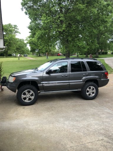

Nice build! I will be stealing a few of your ideas. I am building an 04 Overland that I picked up a few months ago. It is going to be an Overland build but will see a little rougher terrain down here. I worked as a master tech at a Jeep dealer for 14 years. The rough Idle on the 4.7's is usually O2 sensors. I bought this one cheap with fairly low miles because of the rough idle. Replaced all 4 O2 sensors and it idles like new and I am getting 19-21 mpg on strictly highway driving. I replaced the plugs, coils, water pump, and radiator as preventative maintenance. 4.7L's do not like to be overheated. I've put a winch mount on while I had the front bumper off and ordered a warn winch with synthetic rope. I had to loose the factory tow hooks to install the mount but the winch will make up for it.
That's a clean Overland! Full aluminum radiator?? That might be in my future. I'm not overheating but I've noticed with my OBD2 monitor the coolant temp hasn't gotten higher than 212. I've gotta do something more, so any advice you have would be welcomed, especially for cooling and MPGs. You might look at Fawkes Fab for their recover points for the front. Worth the wait and $$ IMO until you move up to a new bumper. OEM coils? I am plugging through maintenance and some minor issues due to the age and PO not taking good care of the rig. Between my lift, tires, and roof basket, I'm getting 15 average. I can squeeze more out, but traveling below 75mph kinda stinks on the hwy.

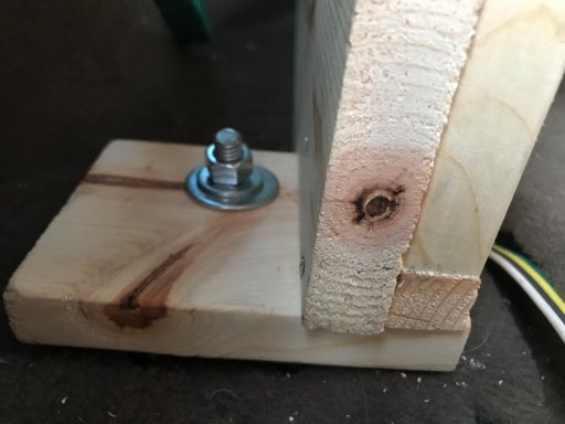

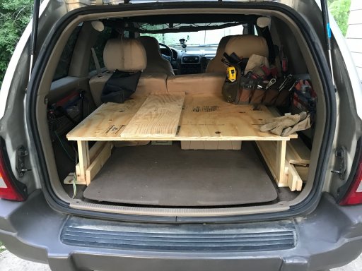

Small update on the platform. Had a few minutes the other night and test fit the tie down idea. Cut them down to fit and get rid of excess. Looks like it'll work out nicely. Hoping to get some more done this weekend.
Thanks! I was very happy to find it. I looked for 4 months and was about to give up and buy a limited when it showed up on craigslist. As for the radiator yes. Its full aluminum. I got it off ebay for $189 shipped and its been in a month with no issues. The factory plastic radiators are prone to failure so this solves that. I had to modify the fan shroud but other than that it was a bolt in. I replaced the hoses and thermostat at the same time as the radiator. The Jeep still has the factory coils and they weren't sagging at all but I started on my lift last weekend. I will post pics when I am done. I plan on running 265/70/17 BFG's. I imagine my mileage is going to drop close to yours after the lift and tires.

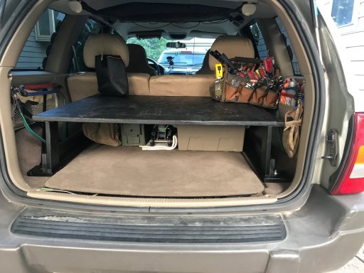

Aside from a little bit of sanding and paint, I'd say it's done! I was originally planning on adding wings on either side, but the better half made a good point about being able to fill that space in better with small/soft gear. So, sanding, a few coats of paint, and bed liner on the lid, and it's done!

Looks good! What kind of bedliner are you painting it with? I am going to do something similar because my spare wont fit in the spare tire well any more. I will store stuff in the spare tire well and slide the tire in the open space above it. Then I can put cooler and other things on top. I finally finished my lift. I am riding around on factory tires until I get my new ones put on. It looks like its on stilts.
I have a bit of black Rustoleum Truck Bed Liner in a rattle can that I'll use. I like the look of it as the texture is very subtle yet it grips decent. I'm honestly surprised my spare fits and also surprised that it doesn't. I scoured the internet and it was supposed to fit just fine, but the variance in true size is to blame. Depending on your size, you might consider leaving the spare in the well if it'll fit. I had the same idea as you, but I've found that I haven't ever had to reach for my spare. The one time I had trouble, I was able to temporarily fix the leak and kept air in it until it could be professionally plugged. These tires are pretty stout compared to the previous set, but the extra plys help as well. I won't go any bigger on this rig, well, at least until I get a carrier. I stuck with the factory size for over a year on my lift. Looked a little goofy but more so looked like it was missing something.

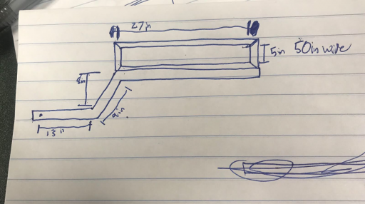

I have been mulling over the idea of a DIY hitch basket since my rig will be loaded to the gills with gear, hoomans, and doggos. I'm not much of a welder, but thankfully my father is. I sent him this sketch a month or so ago with the idea of building it on the weekend I'm up to help at the family farm:
He build a lot of the gates, bale rings, and other odd and ends, not to mention his metal fab business, so he has the tools and scrap materials around. Well...I went up this past weekend and put in about 26 hours working with him, and we ended up pulling a late night to knock this out as wellIMG-6871.JPGIMG-6872.JPG
We were getting a feel for the ground clearance as well as the liftgate clearance. We ended up raising the support bar up about 6 inches from the receiver for added ground clearance and the liftgate clears with about an inch or two to spare. Will post more pics when done as I'll be knocking out the final welds and paint this weekend while I'm up for Mother's Day.
I finished my cargo/trunk platform and I am very happy with it. My gear is more organized with it and it free's up a bit of room for more gear and the dogs.
He build a lot of the gates, bale rings, and other odd and ends, not to mention his metal fab business, so he has the tools and scrap materials around. Well...I went up this past weekend and put in about 26 hours working with him, and we ended up pulling a late night to knock this out as wellView attachment 97104View attachment 97103

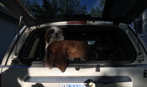

However I don't think the dogs are fans of riding on top....

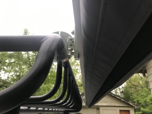

And finally! I was able to use my Fourtreks mounts for a new item ;)
View attachment 97094View attachment 97095
My DIY awning was great in theory but it was a paint to use with my limited space to haul it on the inside, plus it was already just a temp solution until I got the basket extension (which I did about a year ago), the right mounts (got about a month or so ago), and pulled the trigger on the awning (came in yesterday!). This rig is coming together slowly, but I am making more conscious decisions with it and upgrading/adding on wisely. More to come before OXW!
