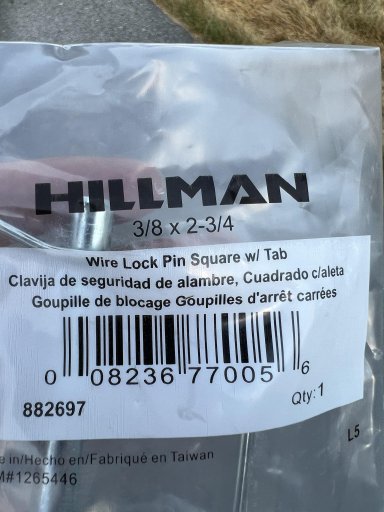

Last weekend I added quick-release rear seats. This was an easy mod, but it allows me to quickly remove the rear seats, which gives me another 7-8 inches of room in the back. I eventually want to create a sleeping platform, but I am going to make it sectional so that I can continue using the rear seats for the tiny humans lol.
I drilled out the old pins that held the rear seats in place and added locking pins. Pretty nifty, if I do say so myself.

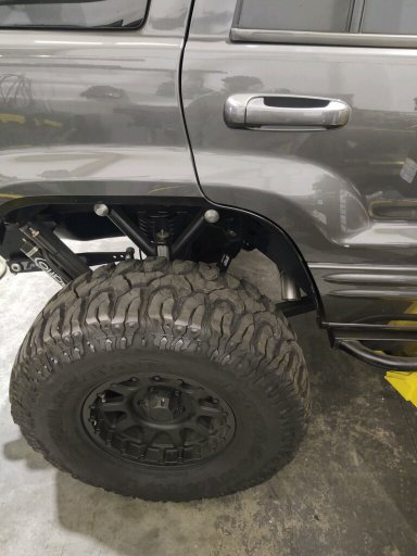

The size of the wheel well opening on the WJ is a big downfall when trying to run bigger tires. Currently I have 4.5" springs on short arms with 33's, both axles are pushed out about 1/2" and with a lot of trimming I still rub at full lock when flexed. If you think a fender trim is in your future check out my build thread, I did a write up when I tackled mine with lots of pictures of what you'll run into. It might give you some ideas of how you want to go about it. Good looking WJ
100%

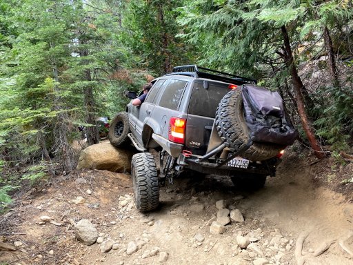

It's hard to say exactly what my lift is, since it's very custom. But doing some basic measuring vs. other WJs I'd call it a 6-7" lift. I run 35"s with some significant fender work (done right) and still get a tiny amount of rub in the rear at the front of the openings (I need to shift my rear axle back maybe 0.25").
