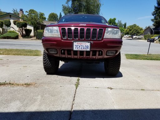

I have a 4" by rough country on it but the lift is gutted only thing left is coil springs. Plan on going to a 4.5-5" on it with long arms. Need a rear bumper and front locker. I also plan on taking out the small rear seat and building a tall lock box in it.

Love seeing new builds of wj's. I remember when I was doing the same and 3 lifts later I ended up with long arms and 4.5" of lift. I just was never happy with 2" then 3" lifts. Would've been way smarter and cheaper for me to just do it the first time.
Be careful with the drop kits from iro. Make sure to re torque the bolts every few months. I've seen and heard of some backing out over time.
It's looking great so far though!!

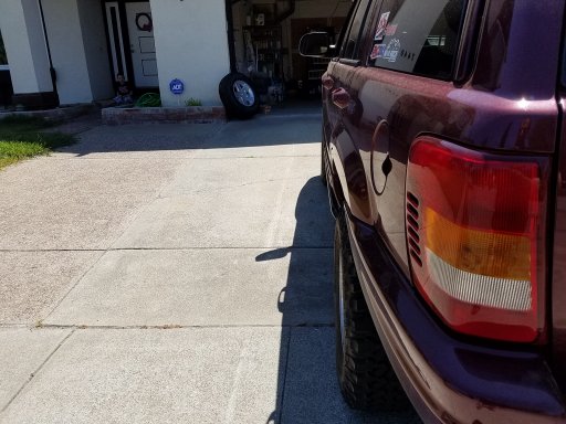

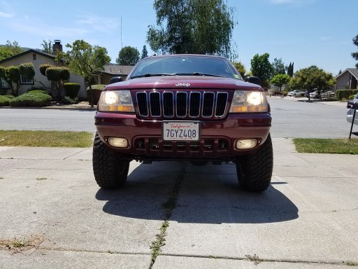

So long time no update. I was able to finally go out and test my 4" lift. I now know that I will extend my bump stops in the front a rear. I was rubbing hard and that was causing my Jeep to get stuck a few times as tires where wedged in my wheel wells.

Thats a good looking WJ!! Cant wait to start building mine (Plans are bigger then my wallet!!!)
