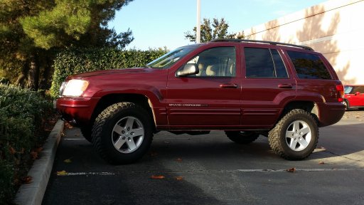

OK so I am starting this build as I have started buying upgrades for my WJ. Here it is as it sits now.
2" Lift
JK Tires and rims (255/75-17) x5

I have an 04 WJ. Have 2in BB lift and 245 75 16 Duratracs.. you have to trim or have much rubbing with your current setup? I had to trim a decent amount off the wheel well lining and I still rub backing up and turning.

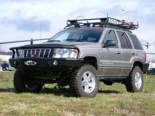

I have an 00' WJ with a Fat Bob's Garage 2.5" lift kit, came with new shocks and coil springs, I also added longer rear sway bar links. The ride is more firm it not harsh. I like suspensions on the firm side though. There is a bit more body roll though. Overall it's a good quality kit for the money.

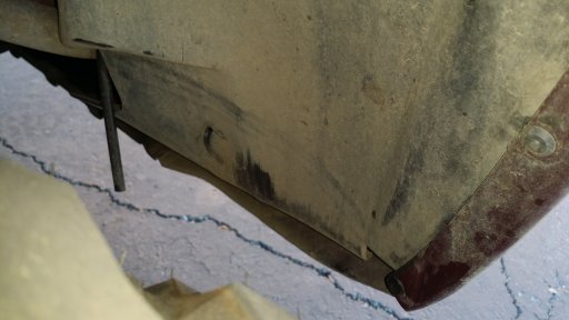

I have no rubbing when I reverse but if I turn very hard or go over a bump. It does look like you two have done some trimming. I will be too this weekend. Don't want to buy a lift until I've gone off road once. Thanks for the feed back!

Its just ever so slightly rubbing but enough for trimming. If Hollister goes well then I my skip the lift and buy the Bushwacker Flairs.

I trimmed about 2" at the bottom of my front bumper, I cut just the bottom and the outside, left the top attached creating a flap, I pushed the flap, with the inner fender still attached forward into the bumper and secured it with some stainless steel sheet metal screws. I have no rubbing besides this. I am running 1.5" wheel spacers though because my tires would other wise sit on my rear shocks, badly. The 1.5" spacers only gained me .75"-1" of clearance at the rear shocks. Some of that is due to the large diameter of the rear shocks that came with my lift kit.

I should only gain another 2" with this lift, maybe 3" at the most with the new springs. I'm on 255/75-17 (32.5") so I'm in no rush for anything bigger. Looking to eventually go to a 33x12.5x17 but only after my tires are worn and I have my finders trimmed.
